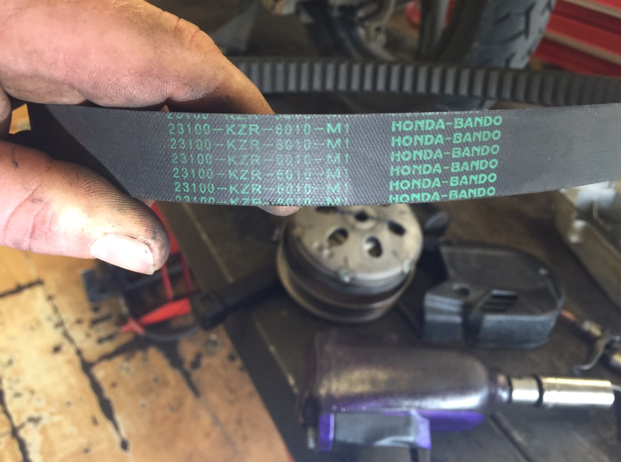

I have a pcx 125 2013 - I am worried about buying the wrong belt and rollers as there are so many different ones and I can't seem to find the ones in looking for plus the manual doesn't tell you what size and weight the rollers are so I can't buy the right ones - plus everything is complete oem nothing is uprated what so ever
Belt
23100-KZR-6010-M1 - this is what it says on my belt.
Plus I would like standard rollers + weight + size dementions
Thanks guys :)

I've done 9892 miles - but when I have the clutch off to grease up the bearings and everything the rollers looked warn and the belt has cracks in it so I thought I'd replace while still running instead of being stuck somewhere wondering what the hell is going on lol

Hold on there cowboy... if you are going in to grease stuff you will need a service manual. There are 4 things to check or replace to gain back factory performance out of the drive train. Minimum tolerances are listed if they don't need to be replaced as stated in the SM.
Poor performance at high speed or lack of power...
1. worn drive belt
2. weak driven face spring
3. worn weight rollers
4. contaminated pulley faces <----- this is not a grease friendly environment
Do you have the service manual? All the wear tolerances for various parts are listed in the SM for 2013 PCX. OEM parts found in the catalog GN was showing you.
