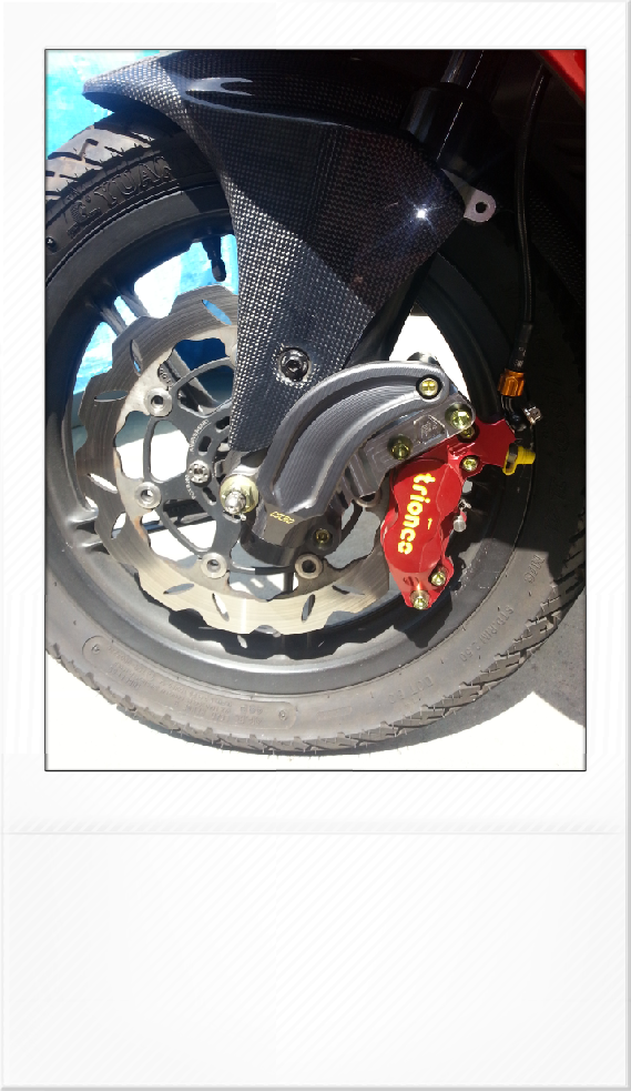

My new front brake system for Honda pcx150
260mm rotor
k2apache6.0

It's a NCY 260mm rotor & a AZIX caliper adapter & TRIONES 4piston CALIPER
with all GOLD titanium bolts by Pro Bolt . BREMBO RCS 19 brake levers.

The performance is killer! !! STOPS on a dime & grate when I'm white lining between cars .

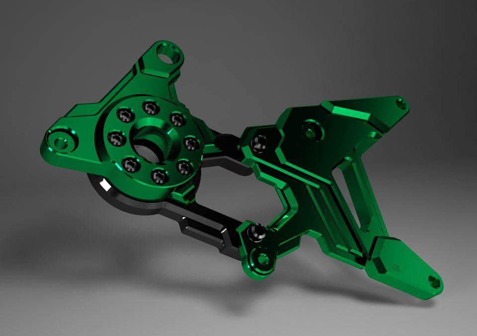

Honda pcx cnc swing arm

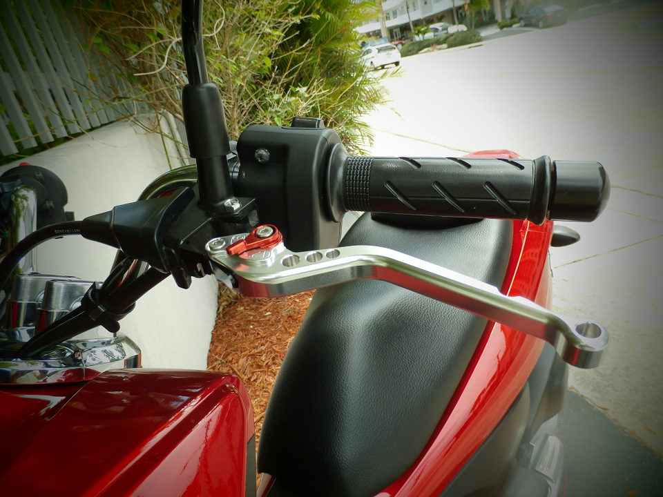

OK, Got my wave 260mm brake rotor, caliper bracket, and adjustable levers in the mail. Will post when I get them installed

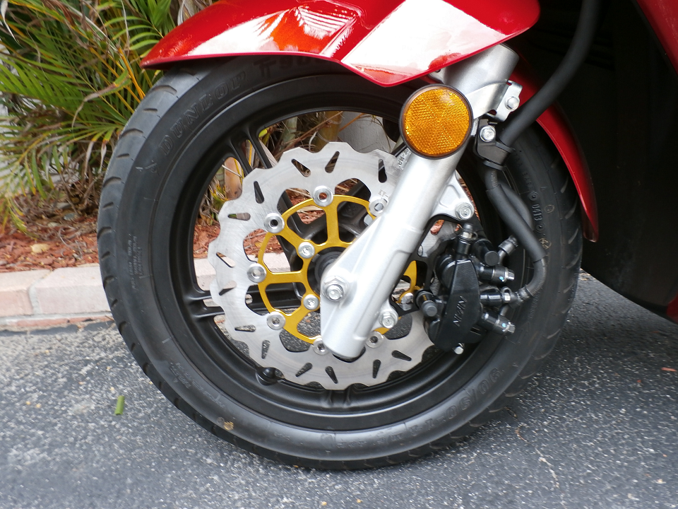

Post by k2apache6.0 »
PCX Brake 1.png (1.3 MiB) Viewed 6334 times
PCX Brake 2.png (1.21 MiB) Viewed 6334 times
Here we go, freshly installed and finished, awesome. 260mm floating wave rotor with caliper offset bracket. I Also got some adjustable custom CNC levers while I was at it :D

Re: New front brake
Post by txpcx13 »
Any braking performance increase with the stock caliper on the aftermarket disk?
2013 Honda PCX (Red) - NCY 13g rollers, golden variator, drive face, YSS shocks, Givi E450
2014 Honda Forza (Red) - Adige 17g rollers, Kappa K466
k2apache6.0
Posts: 507
Location: Fort Lauderdale, FL
Re: New front brake
txpcx13 wrote:Any braking performance increase with the stock caliper on the aftermarket disk?
Been riding it just over a week now for around 70-80 miles, and the new disc is still bedding in to the old pads which had plenty left on them @ just 1500 miles usage. I'd say I'm noticing a difference to the point where the stock fork springs feel softer than before, most times one finger is enough. Over the last day or so it really has improved a lot!
My PCX mod build here..

Re: New front brake
k2apache6.0, I like that upgraded brake assembly. Did you order it online? How many items have to be replaced of the original pcx front brake assembly?
k2apache6.0
Posts: 507
Re: New front brake
Mel46 wrote:k2apache6.0, I like that upgraded brake assembly. Did you order it online? How many items have to be replaced of the original pcx front brake assembly?
I ordered from webike Japan, got here in just 6 days.
The only thing you replace/discard is the oem steel caliper backing plate/pin bracket. You remove the pins from it and transfer them to the new caliper bracket. I had a brain fart when first figuring it out but it went smoothly enough after that.
Here's a link to the rotor/bracket kit I purchased, I also added a 0.70mm shim washer between the fork leg and the wheel spacer on the brake side as the 'buttons' on the floating rotor come extremely close to the caliper bracket under rotation. The stock caliper and rotor mounting bolts are used, and I found it necessary to rotate the hose banjos slighty to allow the oem hose bracket to line up on the fork leg which required checking for bubbles in the fluid afterward (if you have a spongy feel at the lever). The kit is high quality, well packaged, and available in 5 colors. There you go.
