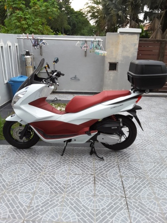

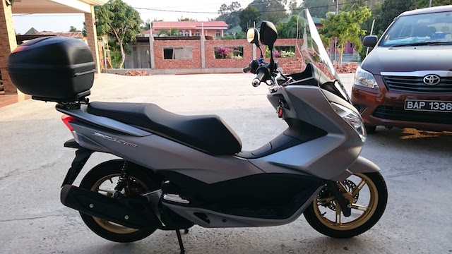

I got Givi E30TN box and Givi SR1136 mount. I think the size is just right. E26 would have been too small and wasteful. Maybe, max a 33L box for a PCX to not look oddly out of proportion. No drilling needed for my 2015 PCX, so if i decide to go back top(box)less, it can be done without leaving any sign I had one before. The mount is solid metal and seems very sturdy.
Here is mine, just after installing it myself (with help from Dad):

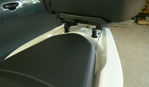

Yes as others have said, there's a piece that comes off so that you don't need to drill any holes. And the assembly is pretty easy.
I got mine because there was no way that any of my helmets would fit into the stock case.
And I posted pictures at... http://www.hondapcx.org/viewtopic.php?f=7&t=5410

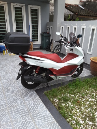

The Givi 43L fitted on
I am 6'1 so while sitting on the bike, the box doesnt look too big

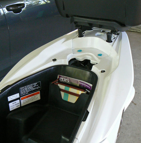

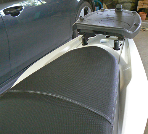

Pictures of what it looks like, if you just take off the removable plate,
without doing any drilling...
The inside (I've put turquoise tape over the remaining unfilled holes):
With the seat closed:
Without the (easily removed) top case:
If you look at the current PDF directions, they have separate ones for the 2013 models and the later models
(they have you remove the plate and drill it for the later models, but I didn't)

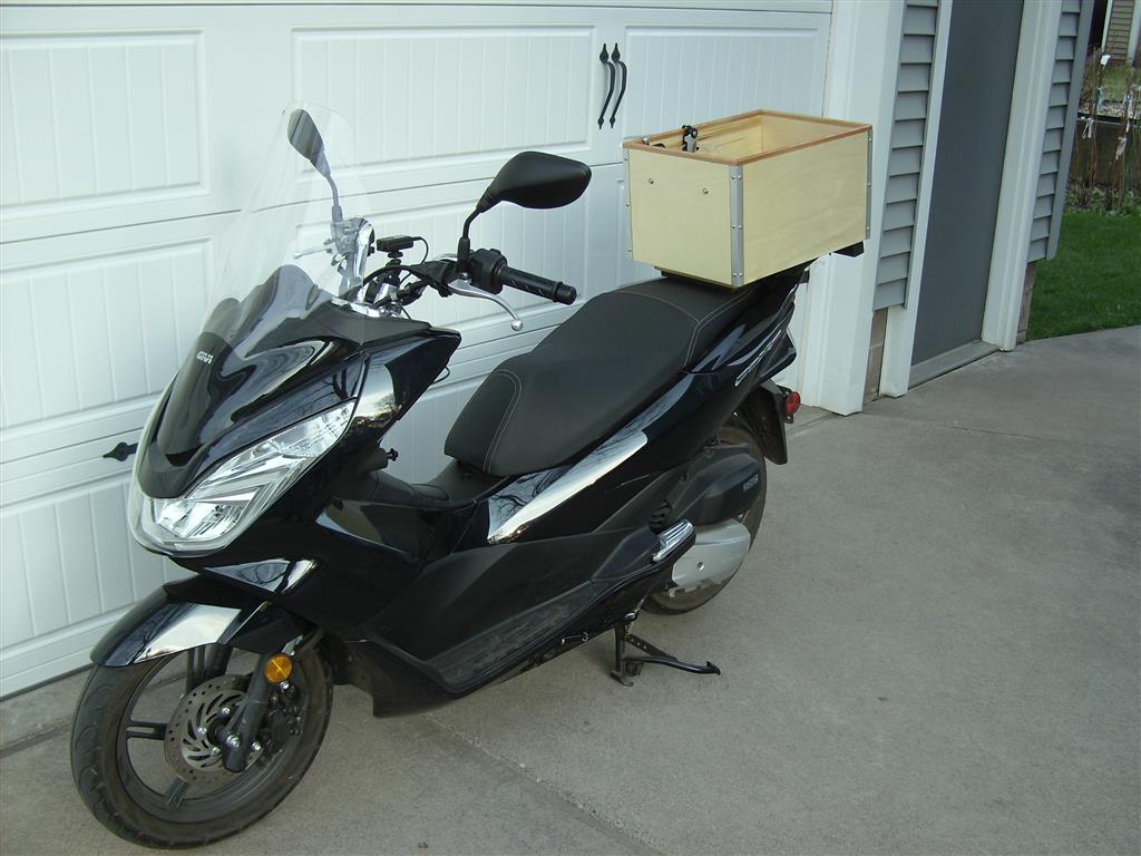

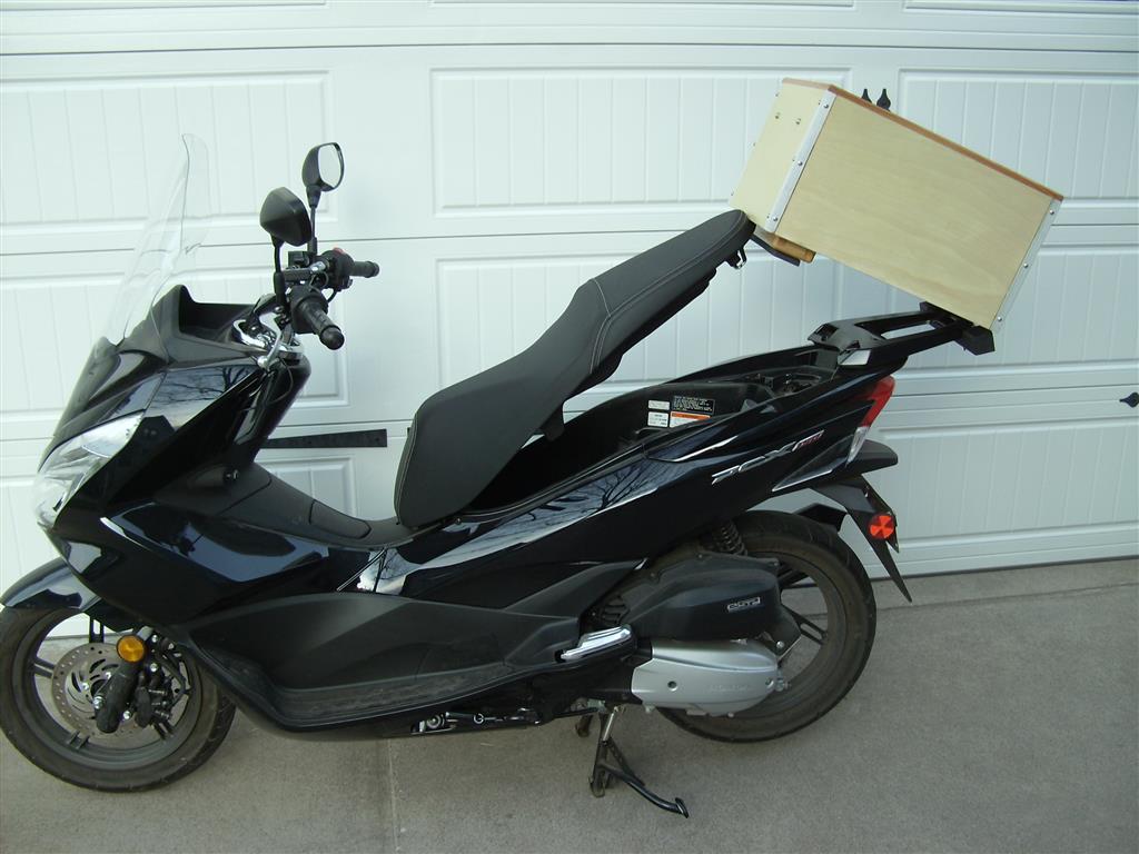

I have a 2015 PCX150 and ordered and installed a rear rack. It does requiring drilling through the top plate which was a little tricky as it's not marked where the bolts go. I took a metric bolt and ground one end to a point, set the plate on top, pressed, and it put a dimple underneath, which I drilled out. You can probably find other and better ways to do this but it worked slick for me. The rack is extremely well built and strong.
I designed my own carrier box, and a friend build it for me. I then designed it to be hinged to tilt so I can lift open the seat. The bulk of the weight of the box is on the seat, not the rack extension. It has been fantastic and I've had over 70 pounds load in it and it doesn't flinch. It'll easily carry a 40# propane tank. The box can be removed with two wing nuts in less than a minute. I don't carry passengers so it works for me. As an aside when I asked my friend to make the box I suggested not to be fancy as I wanted to paint it black. Well, he is a master craftsman and made it out of beautiful wood so I couldn't bear to paint it and varnished it instead.
Re: Top boxes and trunks and mounting racks, oh my
Posted: Sat May 07, 2016 9:45 am
by montliz44
Coolerman, that is excellent and beautiful. Well done! Serious contender for the coveted MacGyver award.
