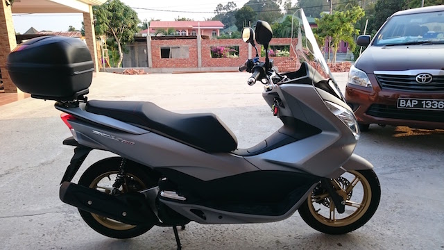

I have been stalking this forum for quite some time. Lots of good info here. In this matter I think I can contribute.
I have a 2106 white/red model. I have fitted a givi rack (can't remember the model) and a givi nm43 top box. Capacity is 43 liters and in my opinion doesn't look too big for the bike. Will post pics if anyone wants some eye candy.
Fitted the box and left the small plastic part covering off. Doesn't look weird as the giving base covers most of the bottom part.
Just don't forget to loctite the screws when fitting.

The Givi 43L fitted on
I am 6'1 so while sitting on the bike, the box doesnt look too big

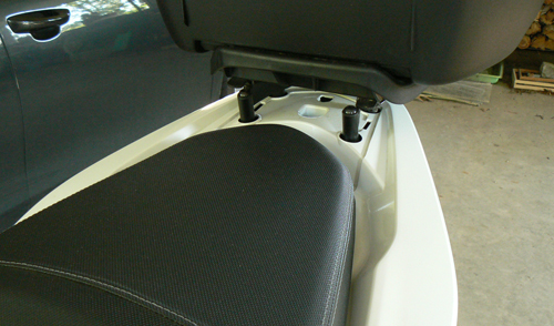

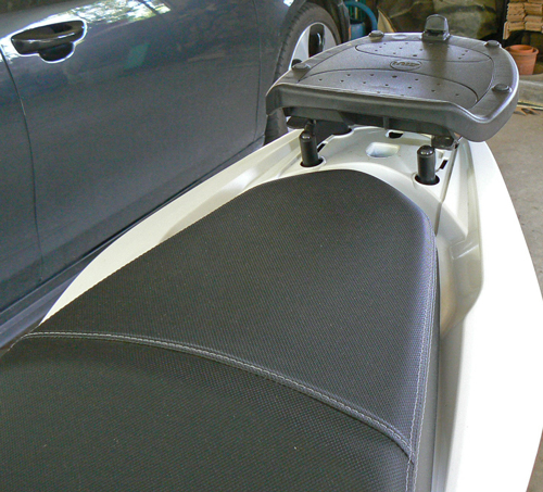

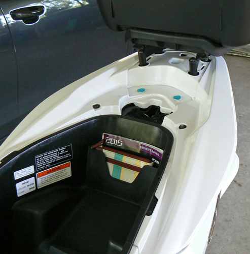

Pictures of what it looks like, if you just take off the removable plate,
without doing any drilling...
The inside (I've put turquoise tape over the remaining unfilled holes):
With the seat closed:
Without the (easily removed) top case:
If you look at the current PDF directions, they have separate ones for the 2013 models and the later models
(they have you remove the plate and drill it for the later models, but I didn't)

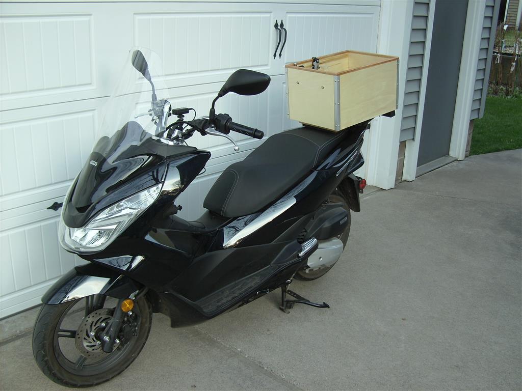

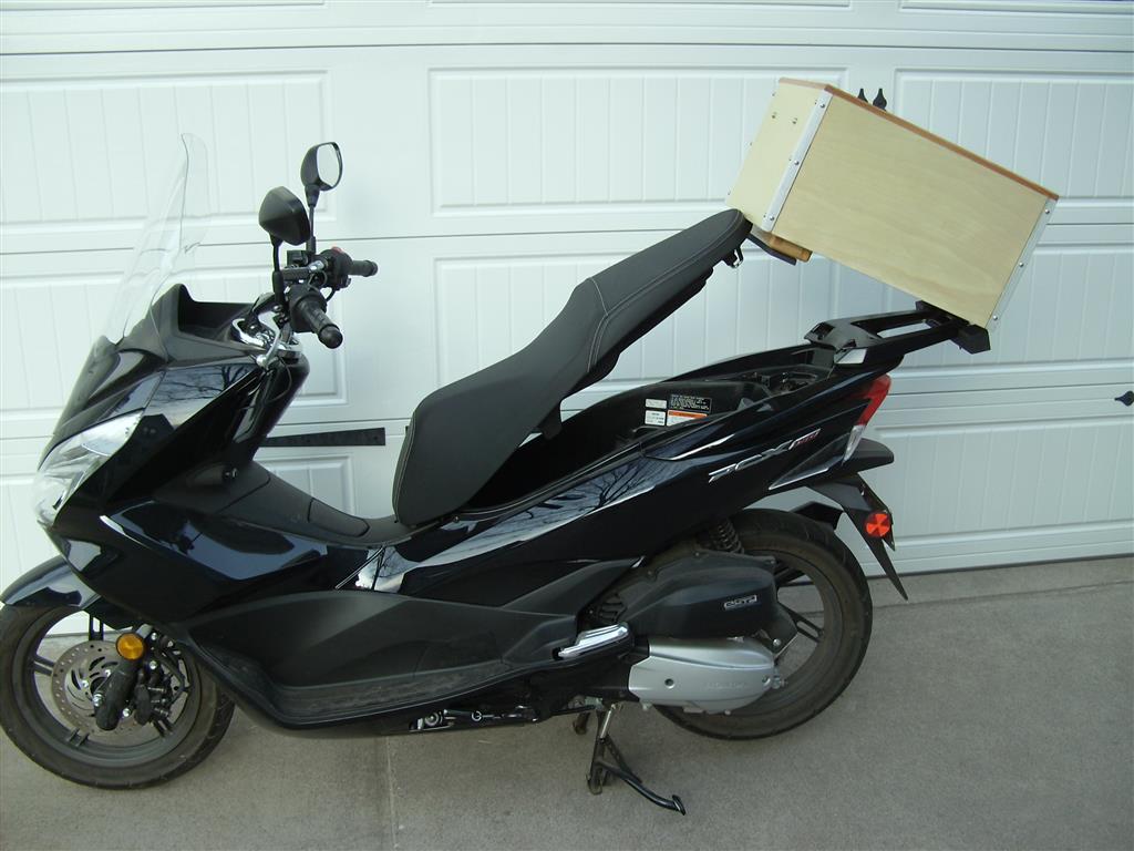

I have a 2015 PCX150 and ordered and installed a rear rack. It does requiring drilling through the top plate which was a little tricky as it's not marked where the bolts go. I took a metric bolt and ground one end to a point, set the plate on top, pressed, and it put a dimple underneath, which I drilled out. You can probably find other and better ways to do this but it worked slick for me. The rack is extremely well built and strong.
I designed my own carrier box, and a friend build it for me. I then designed it to be hinged to tilt so I can lift open the seat. The bulk of the weight of the box is on the seat, not the rack extension. It has been fantastic and I've had over 70 pounds load in it and it doesn't flinch. It'll easily carry a 40# propane tank. The box can be removed with two wing nuts in less than a minute. I don't carry passengers so it works for me. As an aside when I asked my friend to make the box I suggested not to be fancy as I wanted to paint it black. Well, he is a master craftsman and made it out of beautiful wood so I couldn't bear to paint it and varnished it instead.
montliz44
Posts: 313
Year: 2013,2014
Color: red+redder
Location: Galveston, Texas
Re: Top boxes and trunks and mounting racks, oh my
Post by montliz44 »
Coolerman, that is excellent and beautiful. Well done! Serious contender for the coveted MacGyver award.
