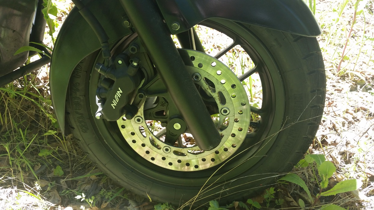

FYI, it fits without any fender mods etc... if any are interested.
It is a good inch+ taller than the 120/70.
davenowherejones
Posts: 1844
Color: Silver
Location: Hope, BC, Canada
Re: 120/80-14 front Forza tire
Post by davenowherejones »
OK, but what brand is it? Any ABS problems? Speed rating?
dasshreddar
Posts: 755
Year: forzaruckuspcx
Post by dasshreddar »
Heidenau K66. I don't have ABS(is it even possible for the for the Forza w/ABS to know the difference?). rated S
It is a common size, most all brands/models are available in 120/80-14.
