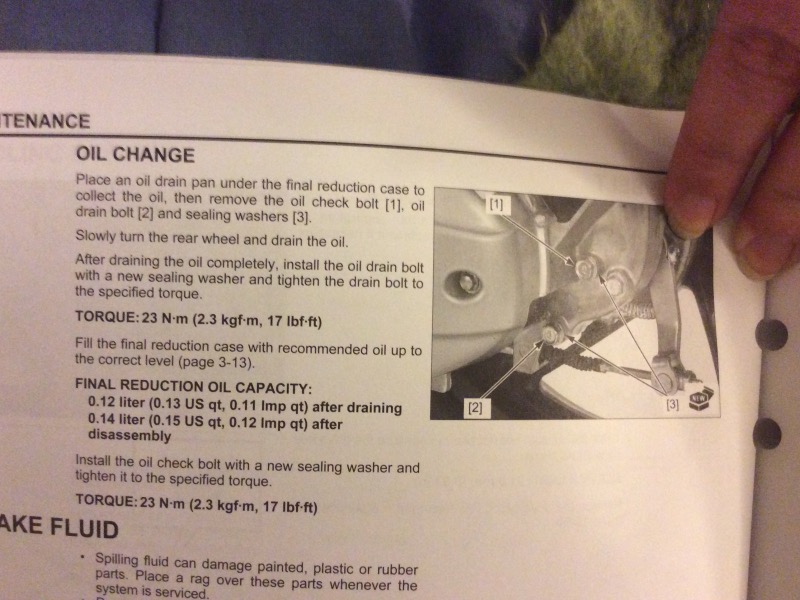

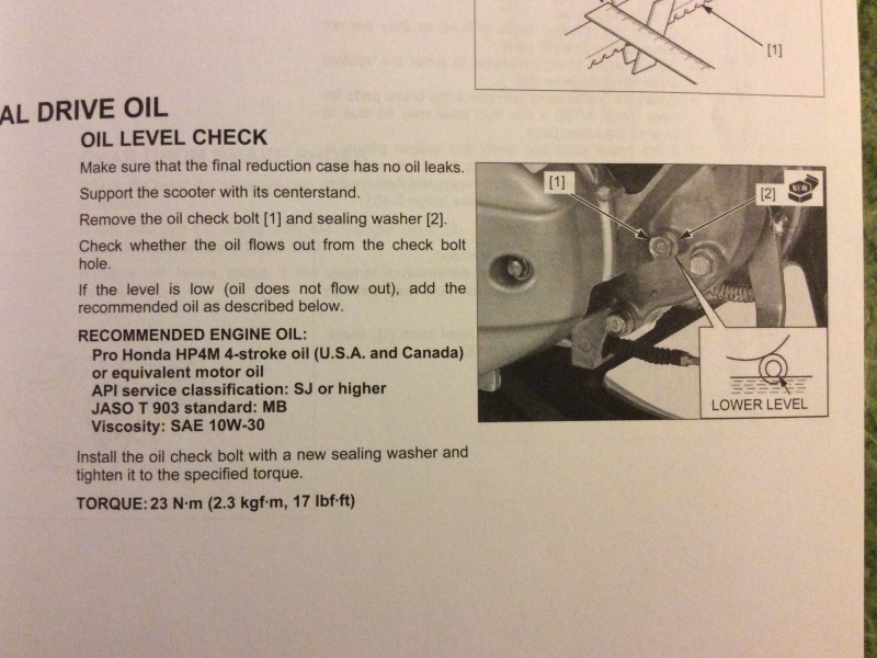

Lastly how do I know how much tranny fluid to add when changing out the out fluid?

You don't need a lot of transmission oil. The best way is, get a big syringe (a motorcycle shop will have one), open the fill hole, open the drain hole, drain the oil, close the drain hole, fill the transmission until the oil is just at the bottom of the fill hole. I can check the manual for the amount if you like.

Ok, here's the info on the final drive:
- image.jpeg (137.39 KiB) Viewed 4280 times
- image.jpeg (131.25 KiB) Viewed 4280 times

Wait I just realized the drive oil is same as engine oil.

Yes, the crankcase and final drive do use the same grade of oil. The final drive uses much less of course.Mike888 wrote:Wait I just realized the drive oil is same as engine oil.
