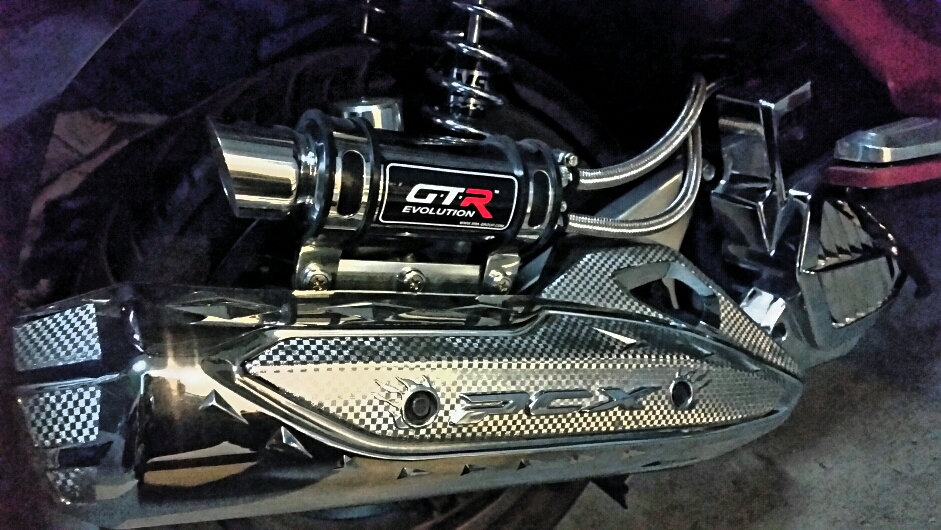

Mods so far.

8) Great accessory choices on your very nice two-tone painted scoot!
We rarely see the black/red combo here on the forum(s) and they're Not available in the U.S.A.
About your carbon exhaust cover and those flames around the bolts, would you mind telling us where you got it/them?

Thanks for the comment WhiteNoise we are lucky here to have a choice of every colour option as panels are cheap here. The exhaust cover was actually all silver until I did a month inspection on it after I heard it rattling. The plastic of the after market cover did not handle the heat as it should and already showed a hairline crack in it. I just followed the inside line with a Stanley blade and after 4 carful passes I snapped it out. Here is a pic of the original part be for I changed it. As the chrome piece was molded off the original oem cover they fit together with ease. Just had to use longer bolts for nylocks to go on the backside. The oil cooler in the pic has been removed as I found it redundant to cool the oil over the hot exhaust. This will have a new bracket made moving it away from the heat. They can also be used as aircoolers before the warm air reaches the airbox. (Also no good attached to the exhaust) lol
