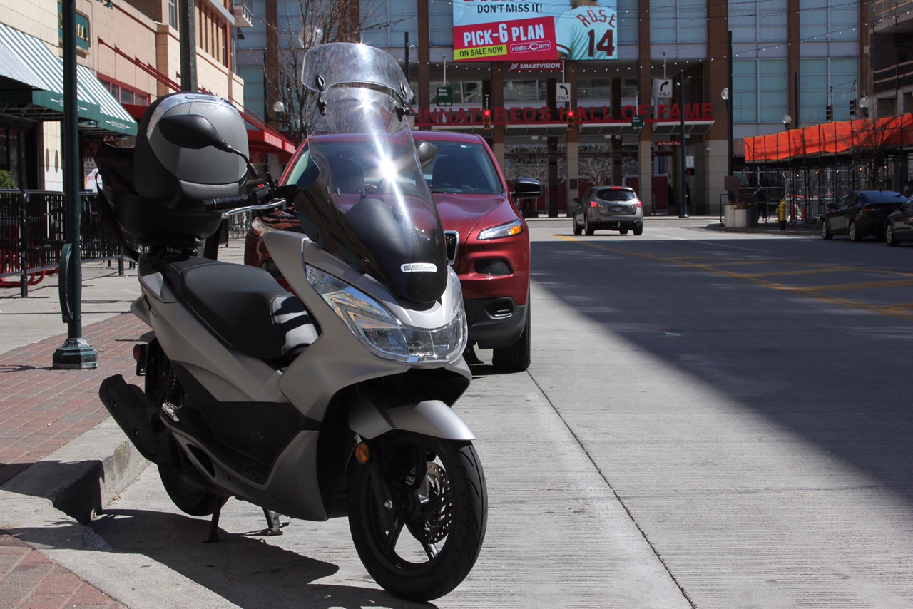

I am six foot, and went with the tall Honda screen...and it was great for the chest compressions resulting from the stock shield, but it beat my head like a malt liquor hangover...
Since I was already in with the Honda screen (in for a pound and many pennies) I opted to get the extender here:
http://www.amazon.com/MRA-4025066125036 ... detailpage
I am really happy with the results - I am quite comfortable, even in the high winds that we've been seeing this year, but I was in for over three hundred for it all. If I had to do it all over again, I would have just gone with the tall Givi or National Cycle.
Just my 2 cents (or more).
- IMG_5465.JPG (396.14 KiB) Viewed 4224 times

Re: What windshield for tall people?
You get no argument from me. The adjustability of the X-creen is a nice idea, but honestly, the straight up position in the pic is both where I first put it and where is is now.
I might play with it some once the weather gets a bit warmer, but it is fine where it is for my chilly morning (and often afternoon) commute.
