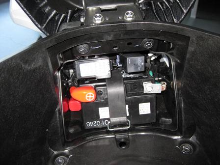

A related battery question: what does the top of the rubber strap that holds the battery in attach to? I can't find anything in the top of the compartment the rectangular metal ring might attach to.
Thanks.
Thanks.
Jon W
Re: Loose Battery Cover
In reference to the strap holding the battery in place,
there is a lower clip that the silver ring mounts over (a lip).
>> You maybe missing that part?
The strap goes over the battery and hooks tight the same way on my (sold) 2011 and (now) 2015 model.
Must be on the 13 too.
Take a look:
Take a look:
- image.jpeg (42.52 KiB) Viewed 2879 times

It's where the other end of the strap attaches to I'm asking about, which you can't see in your picture.WhiteNoise wrote:In reference to the strap holding the battery in place,
Jon W
Robbie
- Posts: 78
- Joined: Sun Feb 07, 2016 5:36 am
- Color: Grey
- Location: Nottingham, UK
Other end of the strap attaches to a similar clip at the top of the battery box. Just a hook moulded into the battery box.
Thanks - I'll have to look for it...Robbie wrote:Other end of the strap attaches to a similar clip at the top of the battery box. Just a hook moulded into the battery box.
Jon W
Now that you said that, you made more sense (to me). Excuse my misunderstanding.JonW wrote:It's where the other end of the strap attaches to I'm asking about, which you can't see in your picture.WhiteNoise wrote:In reference to the strap holding the battery in place,
Thanks Robbie
