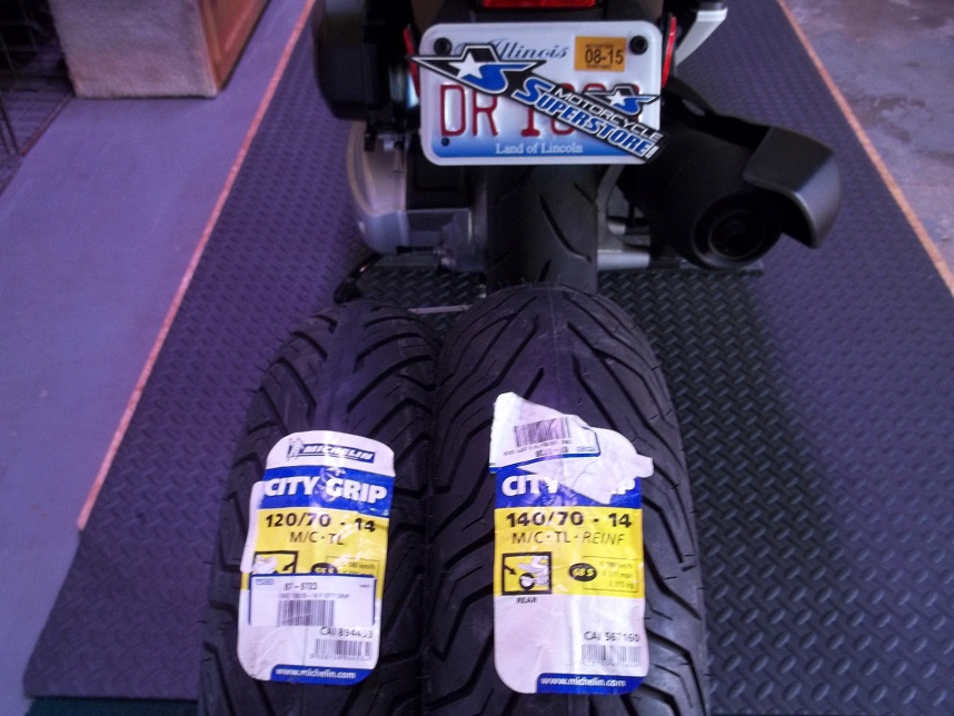

Hi i am new to the group and just bought a project bike. Just wondering if anyone has fitted wider tyres to a 2013 pcx125 if so what have you fitted cheers

There aren't a lot of options in the 14" range. 140/70/14 is as large as you can go, and spacers are required for the airbox and rear hugger (fender) there's a video here on the forum

here is the biggest you can get with the least amount of effort to fit them. The front requires no mod but see the video for the rear fit up.
https://www.youtube.com/watch?v=k7Rh1nmcdAo

I believe you are correct his bike is pre 2015 when a lot of stuff changed. If I could have done it without raising the rear fender I would have. Demon is also correct that the ride changes for the better and the speedometer shows 2 mph less than actual according to GPS. The bikes look healthier and more well rounded but Honda was not going for looks as much as they needed competitive mph to please customers in countries with outrageous fuel prices. You will go faster and have better mph on stock size tires.chicaboo wrote:I wonder if the older OWL model has a bit more space around the rear wheel?

The fatter tyres will increase fuel consumption, adversely affect the ability to change direction quickly, reduce acceleration, reduce top speed and look ridiculous.

That's going a bit far, other scooter's use these larger tyre sizes as do some motorbikes with similar engine sizes, what looks 'ridiculous' about it? It 'looks' better..I'm going to do the mod, I'll report back on the other stuff when it's done and I've had time to check on it, though there may be some merit in those observations

having changed the rear tire on my PCX, I know how much of a pain it is to get the stock size fitted. I can't imagine trying to get something bigger on that dinky little rim. I'm also not sure I'd personally want to run an oversized tire for safety reasons, not without a wider rim to properly fit it on. See, your wheel is designed to take a certain tire width, putting a wider tire on a wheel that is too small will cause the sidewalls to turn inward, which is not how they are intended to sit. This can cause premature wear and stress to the sidewalls that they were not designed to withstand. The results, over time, well, it won't be a good thing that's certain. Appearance mods are one thing, putting stronger brakes on is yet another (within reason), but messing with the tires can get dangerous, even if you think you know what you're doing.

I dont fit my own tires, I go to the mc tire shop who have a proper machine for it. As to your other points I'm aware of everything you state, it aint my 1st rodeo.
As for the mod, there's a good few who have done this already, and all have said it's been an improvement without reservation. I'm not about to second guess Honda, they know what they are doing, but the scoot was designed with practicality and economy as the predominating factor after all. Once I've done the mod I'll report back with honest and objective findings and a long term wrap up ...If I live that long apparently :snicker:
