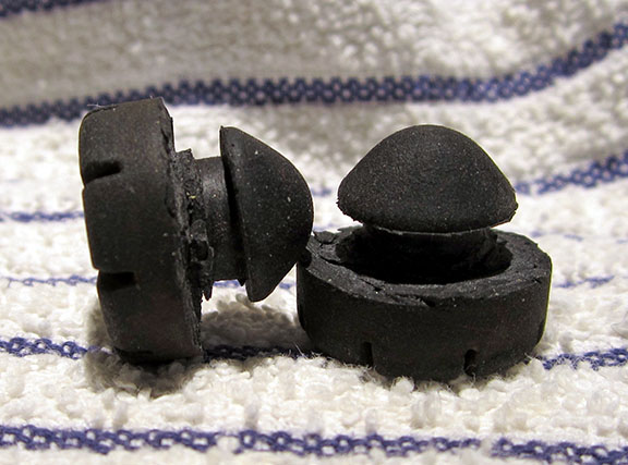

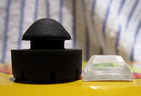

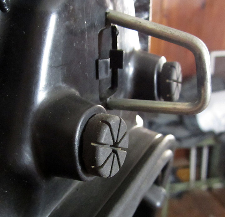

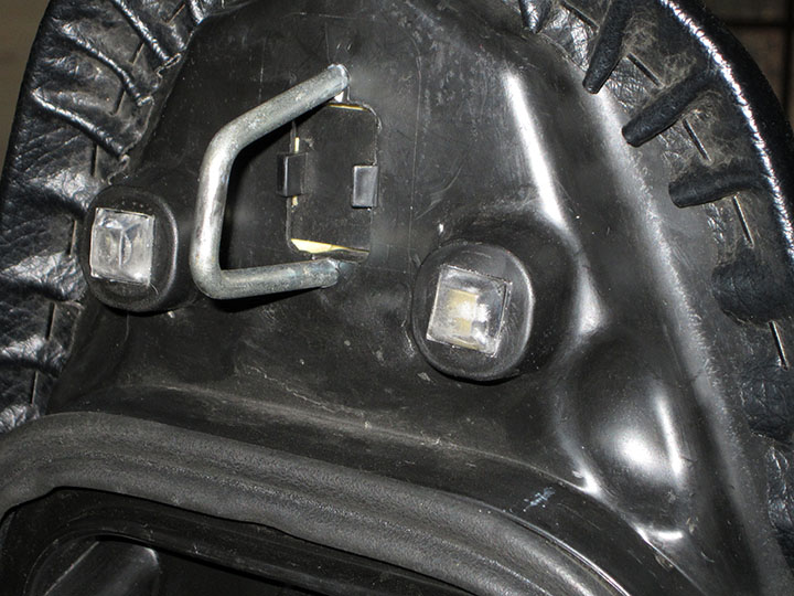

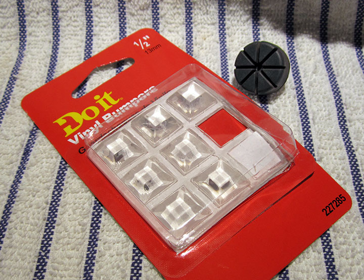

OK, so here are pictures of both the self-stick plastic bumper pads I used, and the now trimmed down OEM rubber bumpers.
The difference between the plastic bumpers and the thickness of the rubber pads (outside the bottom of the seat) was 1/16 in. which was about how much I tried to trim off the backside of the rubber pads. I used a single edge razor blade (in a holder) to score around the circumference of the pad, and finished it off with a retractable knife. You can see the results in the pictures below.
I removed the plastic bumpers I had been using and re-installed the trimmed-down rubber pads and they work just fine. The seat closes and latches with minimal effort now.

Package of 9 1/2in. plastic self-stick bumpers from the hardware store
Two plastic bumpers stuck to the bottom of the seat covering the holes used by the rubber OEM version
This shows the 1/16in. difference in thickness between the plastic bumpers and OEM rubber pads
After trimming some off the back of the OEM rubber pads
The now trimmed OEM rubber pads installed back on the bottom of the seat pan
