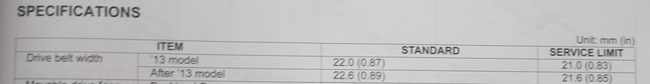

carried over from this thread http://www.hondapcx.org/viewtopic.php?f=9&t=5717
This being the difference in drive belt specs stated in the latest PCX SM. Here we see two different belt widths and minimal wear tolerances between (LED) PCX's and previous years.
The questions; doesn't this picture indicate a thicker belt for the 2015/16's? Did Honda add life to the belt wear by putting the thicker belt on new models and did this slow our new bikes down? If this is true will the (LED) bikes go faster as the belt wears?

Well we don't know exactly what the "new" belt is yet. We know the post '13 belt is 22.6 and that a Click 125 is 21.6 and the original PCX is 21.8 both being 815mm.
My reason for asking the question is that is the performance of the LED is different from previous iteration maybe the belt length has an influence. If the speed is down then maybe putting the longer belt of makes a difference.
I'll wait and see if my contact at Gates comes back with anything! I'll also check the belt # tomorrow at lunchtime.

Thanks and I'm willing to purchase and install the 13 belt on my 15 PCX. I know where my bikes performance levels are (even with the larger tires) and can note any low and high end changes with the earlier model belt. Adding this to my to do list and next video's. WOOT! we love it don't we
