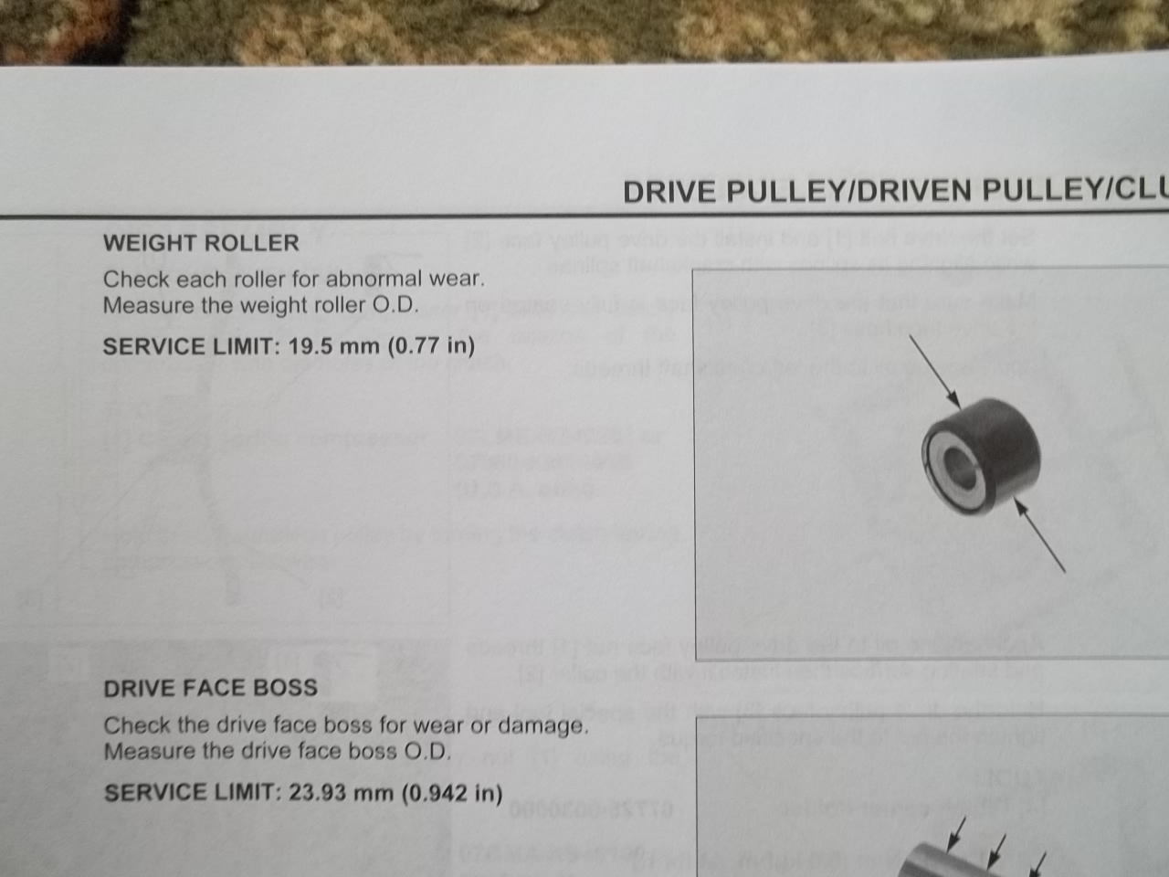

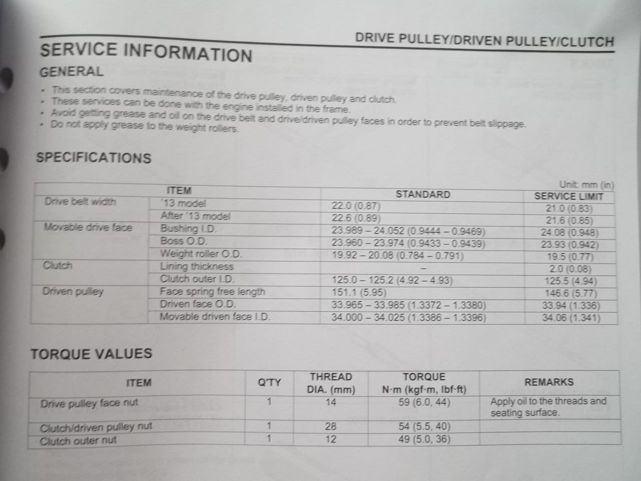

Here are the minimal belt, roller measurements that keep your PCX running hard and fast. Years 2013 and later.
- 100_2979.JPG (481.75 KiB) Viewed 7378 times
- 100_2978.JPG (568.33 KiB) Viewed 7378 times

It's odd that the SM does not give a part number for 2015 PCX150 drive belt.
Only the 21.6mm or 0.85in service limits is stated. Could I ask where you harvested this information?
