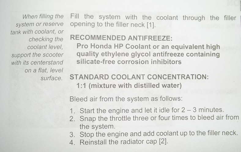

OK, so I found this thread http://www.hondapcx.org/viewtopic.php?f ... t&start=20, but it doesn't advise how much coolant is needed or any bleeding procedure.
I have managed to get about 300ml of coolant in the radiator which just doesn't seem to be enough (even for a 125cc engine). Radiator is full to the brim. Is there a process for bleeding? I can't start the engine just yet as I am awaiting a replacement injector (fuel inlet snapped off).
Will running the engine circulate the coolant, or is there a bleed plug in the cylinder head I have missed?
Any help appreciated.

here is the coolant http://www.amazon.com/gp/product/B0039O ... UTF8&psc=1
here is the latest procedure, not sure why it would differ from a 2011 PCX

Many thanks homie. That confirms engine needs to run to bleed it.
Much appreciated.

Good Lord!
13 US dollars on Amazon.com and the equivalent of 59 US dollars on Amazon Japan.
Me thinks a longer search is ahead.
Or... just by an equivalent silicate-free version from another maker here.

pxc-in-japan wrote: Or... just by an equivalent silicate-free version from another maker here.
That's what I did.
