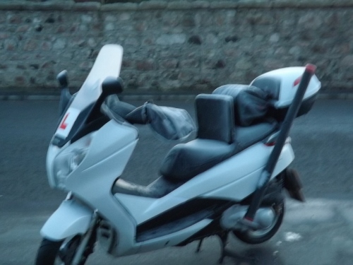

I like riding feet up out of town but felt I was lying back on my arms. Tiring after a few miles. Had a look at what was available. Being short the need was for a rest in front of the hump. Nothing out their that was quick on/off, didn't involve cutting the seat or mounting fixed brackets. Not to mention ridiculous sums of money for what is basically a shaped cushion!
So. . . .
DSCF1324 (500x375).jpg (177.68 KiB) Viewed 1240 times

Nice backrest. By the way, what is that angled post on the side? How is it connected?

Hi Mel, Tube is for carrying my fly rods. Side panel has a hole for mounting tax disc which is now redundant this side of pond, so that provides lower mount, upper mount I drilled the rear rack and used a short section alloy flat bar to mount tube.

Thanks guys. For the backrest I laminated two thin kitchen cutting mats in a curve then three thicknesses of foam from an old camping mat. Sewed up a cover from a charity shop leather coat. Fitted a loop either side to take an adjustable webbing strap to go under seat. Job done. Total cost less than 8 pounds or 12 dollars.
