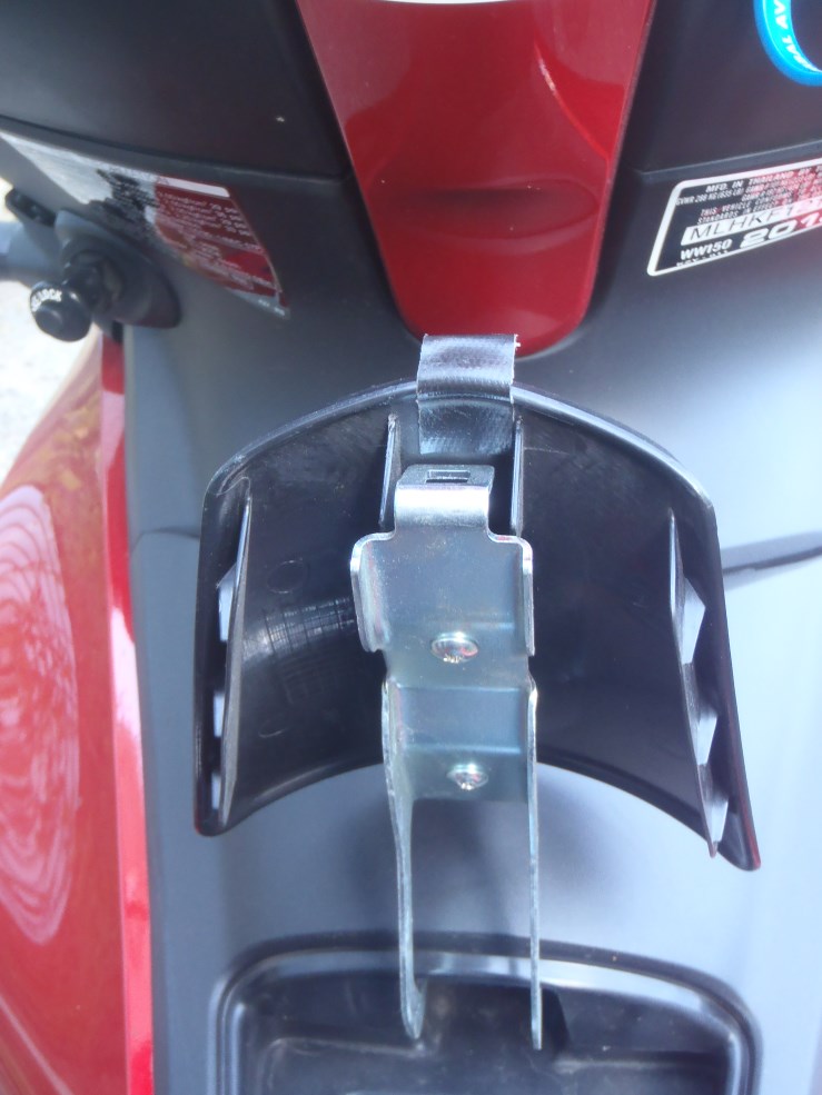

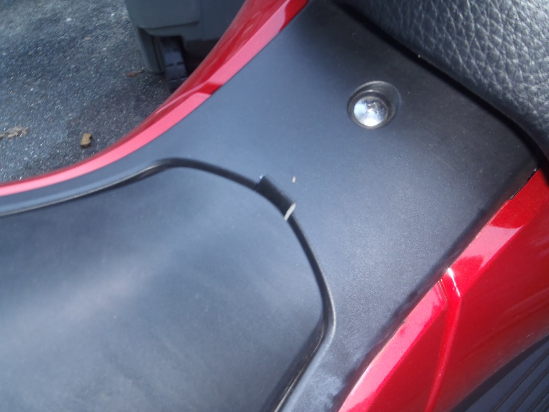

Re: fuel lid
And when you get it open, add a bit of gorilla tape or some such to the lid to help later on. My access door is a bit recalcitrant, and always has been, but a bit of something to grip makes it a non-issue.
- P9150005_renamed_23360.jpg (98.7 KiB) Viewed 1645 times
- P9150004.jpg (127.7 KiB) Viewed 1645 times
