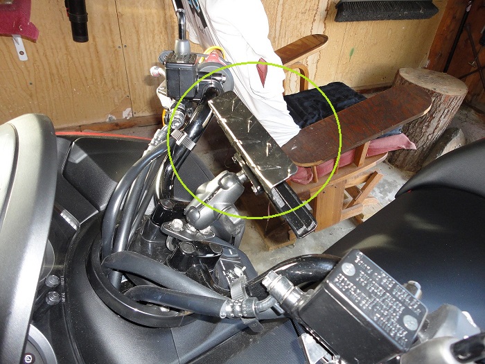

The only reason I bring this up was a new member mounting rigid metal above the bars for accessories that looked to me to be dangerous in an off over the front. I wouldn't want to survive a minor head on collision only to look down and see the family jewels sheered off. The broken windscreen thing was an after thought but I would sure like to see a crash dummy video before I go big screen.

That isn't something I would ever consider doing.
Re: Tall windscreen collisions...
I gus that rider figures that he will never have an accident. I don't know what that thing is suppose to hold but bending a piece of plastic would have been safer. There are also Ram Mounts that would do the job just as well. I know they were trying to save money, but safety was not at the top of their list.
