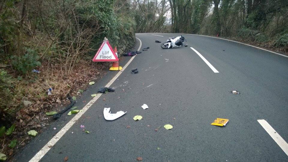

too bad averzun3's bike is not black... he would probably give you his fender right now

What happened?..taking the curve at high speed and hitting some water? No skid marks no other vehicle .
Re: Front fender replacement
He got clipped on his handlebar by a driver passing him. I haven't heard of that happening very often. I think the bike bit the graveyard dust.
Mel46 wrote:He got clipped on his handlebar by a driver passing him. I haven't heard of that happening very often. I think the bike bit the graveyard dust.
