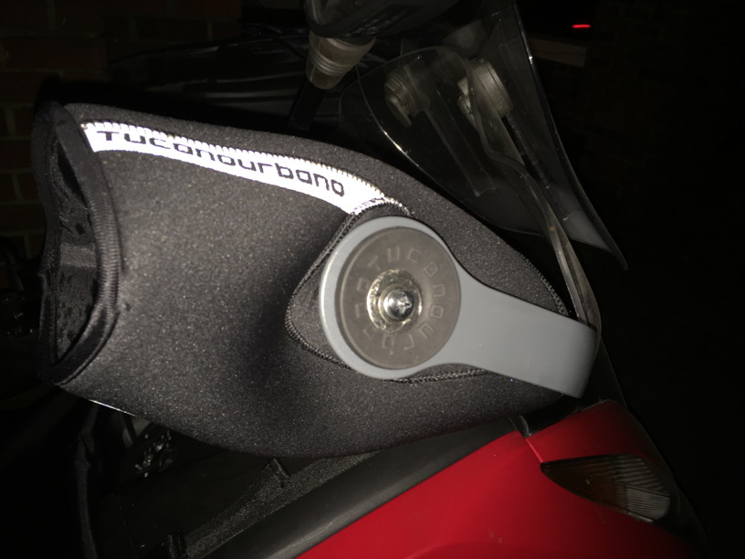

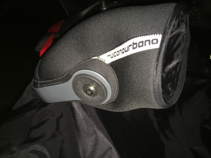

OK, here's my temporary fix for the Tucano Urbano Muffs on my 2014 Forza. As has been noted, they really want a longer bar with a skinnier bar end weight. If one just brute forces the installation with no modifications, the screw that goes into the bar end weight simply pulls through the rubber grommet that fits through the muff and is supposed to hug the bar end weight. You can see in these pictures how the muff is puckered in because I have forced it to hug the end of the short, fat bar end weights.
Left exterior.JPG (109.9 KiB) Viewed 48480 times
Right exterior.JPG (96.08 KiB) Viewed 48480 times
In these two pictures, I hope you can see how I stacked a countersink washer on top of a medium-sized fender washer. These keep the end of the machine screw from pulling through the rubber grommet that comes with the muff. A little blue loctite or contact cement on the threads will keep the machine screws from vibrating loose.

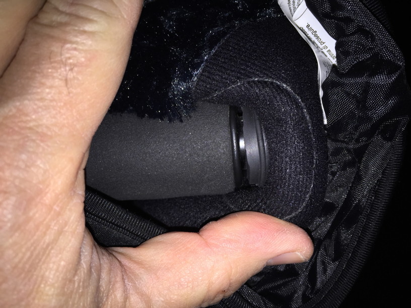

The grommet, aside from being too narrow an inside diameter for the stock bar ends, is too long and grips the end of the throttle grip. I found it easy enough to trim the end of that grommet. Here's a picture of the interior.
Right interior showing cut grommet.JPG (157.54 KiB) Viewed 48480 times

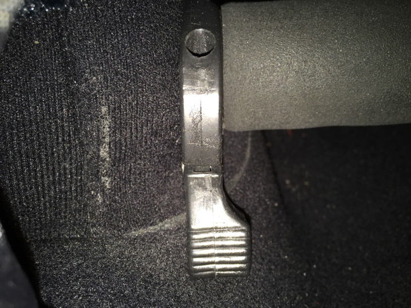

And for those who remember that I adapted a friction throttle lock, you may want to know that it works fine inside the muff. Here it is, again shot from inside:
Right interior throttle lock.JPG (191.57 KiB) Viewed 48480 times
