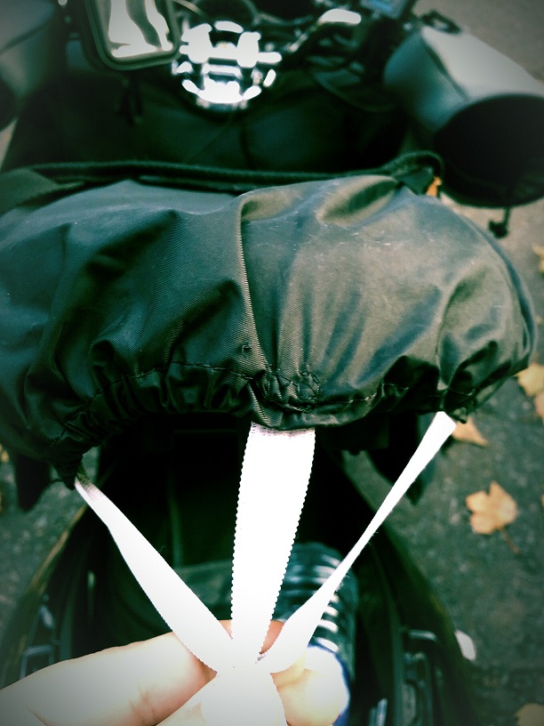

I have a R082 pcx 2016 model fitted the leg covers on but it doesn't completely cover the seat on the back as R082 was made for the earlier models of the pcx.
I have made an mod to over come this though.
Re: Installing a Tucano Urbano R082 on a 2015 PCX
I took some pictures how do i upload them to this site?WhiteNoise wrote:Welcome, can you show us a photo of what you did?
it should help. If not, come back and let us know
yes I sew those 3 parts to the back of the R082.
This elastic band thing hooks under the seat where the seat lock is.
It took me 10 minuets to complete the job.
