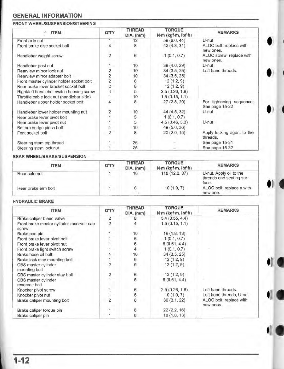

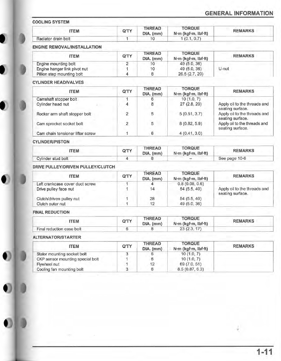

Hi,
was hoping someone here has a workshop manual. Would like to know the torque settings for tightening up the variator and clutch nuts (and also the large 39mm one on the clutch - but figure that one is a tight as you can).
Going to change the rollers and clutch torque spring. Not urgent as some of the bits are on back order so I have to wait several weeks before I get them. Cheers,
Nobody.
Re: Anyone with a Workshop Manual?

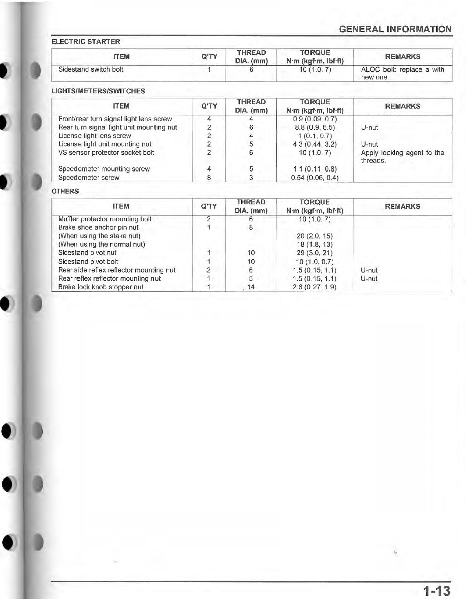

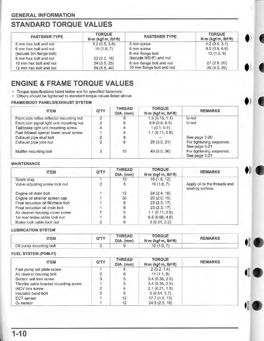

Even if someone had a digital manual, it couldn't be posted because that would violate US copyright law: http://hondapcx.org/viewtopic.php?f=3&t=17#p22
Luckily, me or other members with the physical copy can upload snippets under "fair use" conditions without violating copyright law. I still recommend getting one, they're quite affordable, but below are all the torque settings provided by Honda (look on 1-11, under Drive Pulley/Driven Pulley/Clutch):
