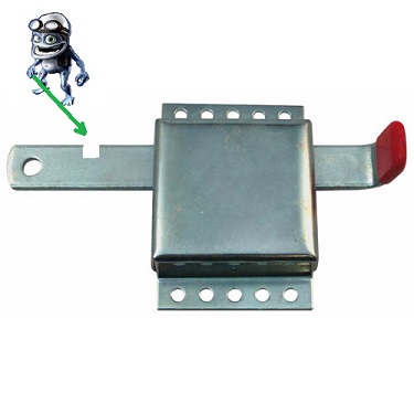

View this lock alteration as you don't want to be able to release the locks when panels are separated. There is a fair amount of upwards pressure on those lower panels but the notch will keep you from sliding the bar until the doors are fully closed.
Child safety always but prototypes should not be left unattended with children anyway. Still looking for issues but the worse I see could happen is the uppercut one might get if those lower panels were released accidently LOL. Buy and always use both locks and cut this notch for safety. You will find this to be a very useful invention.
