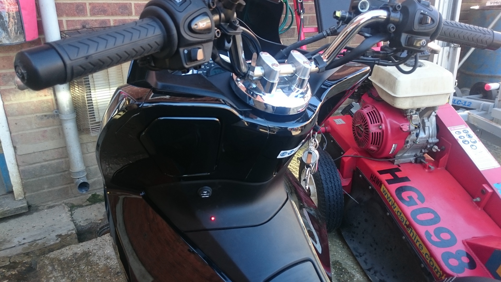

Have just fitted thes, currently £35 on amazon, a worth while addition.
- DSC_0270.JPG (713.76 KiB) Viewed 5648 times
Re: Oxford OF772 Heated grips.
What is the red thing next to the bike?

They were all right to fit. If your looking to get the factory ones off in one piece I found a junior hack saw blade (scarier than it sounds) was ideal for freeing of the glue on the left hand grip, the right hand one isn't glued as it's just slipped over the throttle slider so that one just needs pulling back on it self, the left oxford one slips on easy the throttle side is more tricky, I filed down the inside of the grip (as suggested in the instructions) but also sanded the ridges on the throttle slider a fraction too, key is to make sure they slide easily on and off dry fitted and then to not glue them (glue supplied) until you have wired them up and checked them.
I took the back box off, rear rack and seat box off and the front left fairing and fed the wires from the grips down the handle bar gap and the cables from the battery round to meet them just behind the front wheel, test run and everything back together they are a great addition.
The idle stop shows green in good time and while running but like the other poster I tend to not worry about it while I am riding, I took the bike over to Holland this weekend and did Papendrect, Amsterdam and Rotterdam and they worked perfect. They warm the whole body I can honestly say.
The red machine is a Stump Grinder.
A stump grinder. Want one
