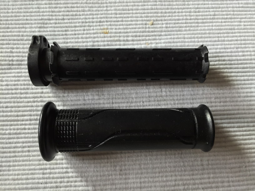

First, look at the third picture; it is of the “throttle grip” (#5 on this fiche <http://www.bikebandit.com/oem-parts/201 ... #sch795511>) taken apart into its two components.
Now, carefully peel the rubber(ish) part up & off of the hard plastic ridge and roll it back along the grip far enough that you can work.
Next, grind / file off that ridge. I used a dremel to do the initial cut and then a grinding wheel on a drill to smooth it mostly down.

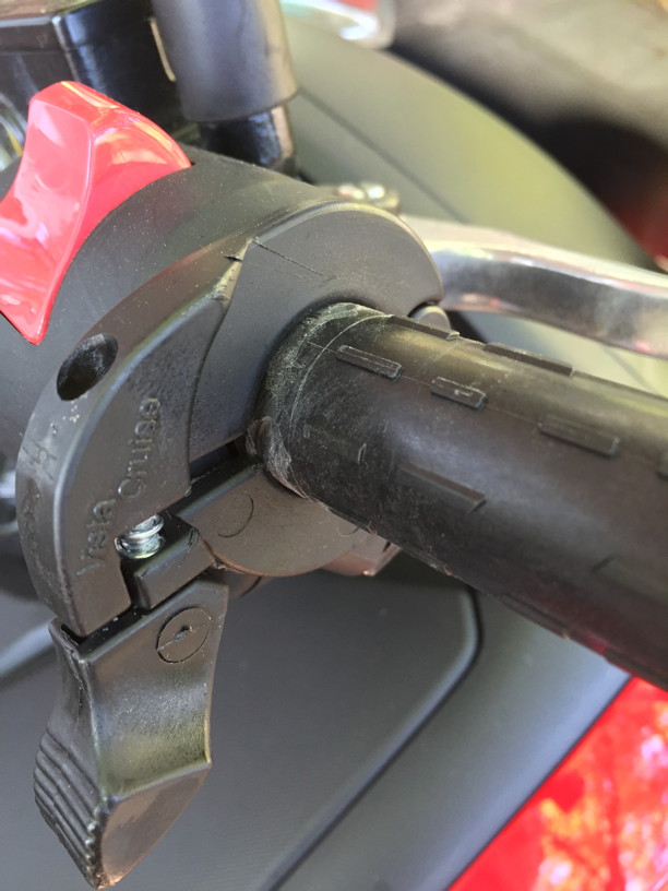

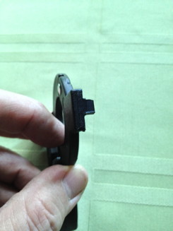

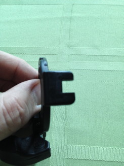

Modify the Honda model Vista cruise by cutting it down so that the now-smaller tab fits in between the two throttle cable nuts (see before & after pix, 1st two pix below).
Install the throttle lock basically according to instructions. I used some industrial 3M double stick on the non-moving part just for insurance, but it’s not necessary. It will look like the fourth pic.

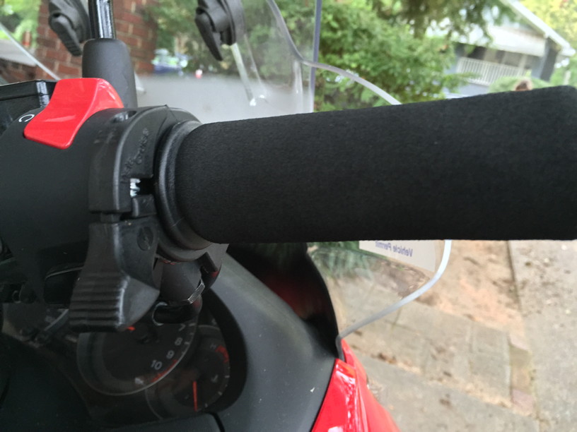

Put some grip glue on the hard plastic part of the grip and roll the soft, rubber(ish) part bact down into place. Use a couple of 16 penny nails or something as spacers to keep the rubber grip from sitting against the Vista Cruise. Let the glue dry.
Put your big foam grip cover back on. It will look like the last picture.
This works a treat on my scoot. I hope that some of you can have similarly good results.

Vista Cruise before modification
Vista Cruise after modification
the two parts of the &quot;grip&quot;; note the big plastic ridge on the inner part of the grip
the two parts of the "grip"; note the big plastic ridge on the inner part of the grip

grip &amp; big foam grip cover installed<br /><br />all done
grip & big foam grip cover installed
all done
