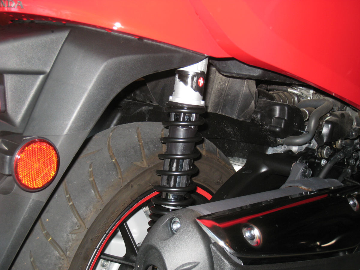

Installed these last night and they are a huge improvement over the stock pogo sticks. Slightly on the pricey side, but not too bad.

Looking good,and the above tension adjuster is a great improvement
Where and what dit you pay for it?

Yes they are much easier to adjust, no clearance issues, and the ride and handling is much better. I paid $249 US for them. Expensive but not Ohlins expensive. We have a shop here called Scooterpartsco.com. They carry a lot of stuff for our bikes not seen anywhere else.

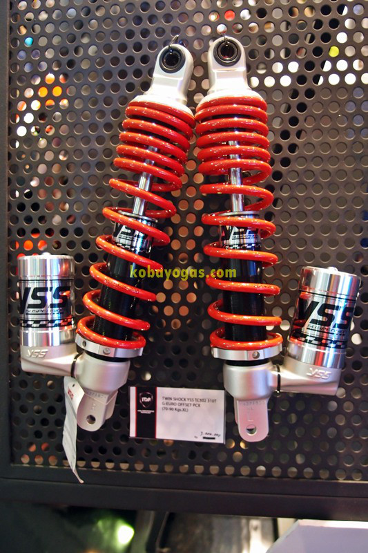

Any reason these wouldn't fit http://www.scooterworks.com/yss-adjusta ... dcyr8-FNrQ
I've been looking at them for a while, price seems similar to your Malossi shocks

Branyers14, I saw those shocks quite a while ago but didn't want to be the first to try them,
bookmarked the site. Now that you've tried them and say they help, I may have
to order them for next year. Right now I'm having eye vision problems so have to
get that corrected first. Thanks for posting about your results.

Those are Thai made aren't they? The Malossis are made in Italy. Take from that what you will, but I trust Italian made more than I do Thai. Had a set of YSS shocks on my old CT70. I wound up switching to Daytonas because they were too soft. I don't know if that will be the case with these or not, they look nice enough and are surely better than stock.

never mind and the YSS picture is for PCX sorry. I don't know the difference or even if there is one. Little bigger view of your bike next time could have helped me see what we were doing here.

When you say the ride is improved with the Malossi shocks do you mean it's smoother and more comfortable? I ride solo and weigh about 140 pounds and I find the ride feels way to stiff at the rear, especially on sharp bumps. it's my only meaningful complaint with the Forza.

I hsve the YSS's and the best way I can describe a good shock is what happens after you hit the bump. A good shock does not jar you and "recovers" better. That's the only way that I can explain it after messing with shocks for 40 years. You can set the preload on most so they never bottom out, but also a good shock will be far more sensitive to keeping things in control at very light hits for holes…
I'm not sure that the YSS is that great a shock, I just think the Honda is a very poor shock. I was selling Honda motorcycles in the 70s and we all agreed at the store that the Honda shocks were terrible. We used to say that they had fish oil in them, meaning it was a very poor dampening and rebound it was almost just like it was a total entire spring. After getting my PCX I felt nothing is changed. And why I did the YSS the first weekend of ownership

The ride is smoother, bumps don't jar the entire bike nearly as much and it seems to stick to the road better.SteveP wrote:When you say the ride is improved with the Malossi shocks do you mean it's smoother and more comfortable? I ride solo and weigh about 140 pounds and I find the ride feels way to stiff at the rear, especially on sharp bumps. it's my only meaningful complaint with the Forza.

Branyers14, the shocks look great and the adjustment also looks easier to do. I'm thinking about ordering a set of them and having a friend install them for me.
To install them do you have to remove panels to get to the upper bolt for the shock? Looks like kind of tight clearances in there between the shock mount and the scooter panel. Might be real tough to get a torque wrench and socket behind the panel.
Are you still happy with them?

Easy install, no panel removal necessary like on the PCX. The upper shock mounts do have tight clearances but can be removed with a standard wrench. Getting a torque wrench or socket in there will be difficult if not impossible.TonyM wrote:Branyers14, the shocks look great and the adjustment also looks easier to do. I'm thinking about ordering a set of them and having a friend install them for me.

Branyers14, thanks for responding back. So it sounds like you did not torque down the bolts for the shocks - at least for the top bolts. Isn't that sort of risky?
How does your bike ride now? Was the expense worth it?

TonyM wrote:Branyers14, thanks for responding back. So it sounds like you did not torque down the bolts for the shocks - at least for the top bolts. Isn't that sort of risky?
Sure, I torqued them. "Tight" is a torque, right?
Bear in mind the Malossi shocks are racing shocks, so they do not have a ton of give, nor are they plush. But the bike absorbs bumps in the road much better than the stock shocks. Handling is improved as well. However, I should mention that putting some quality oil in the front forks may also work wonders. I notice the rear is much smoother, but that the front is in need of improvements as well.
