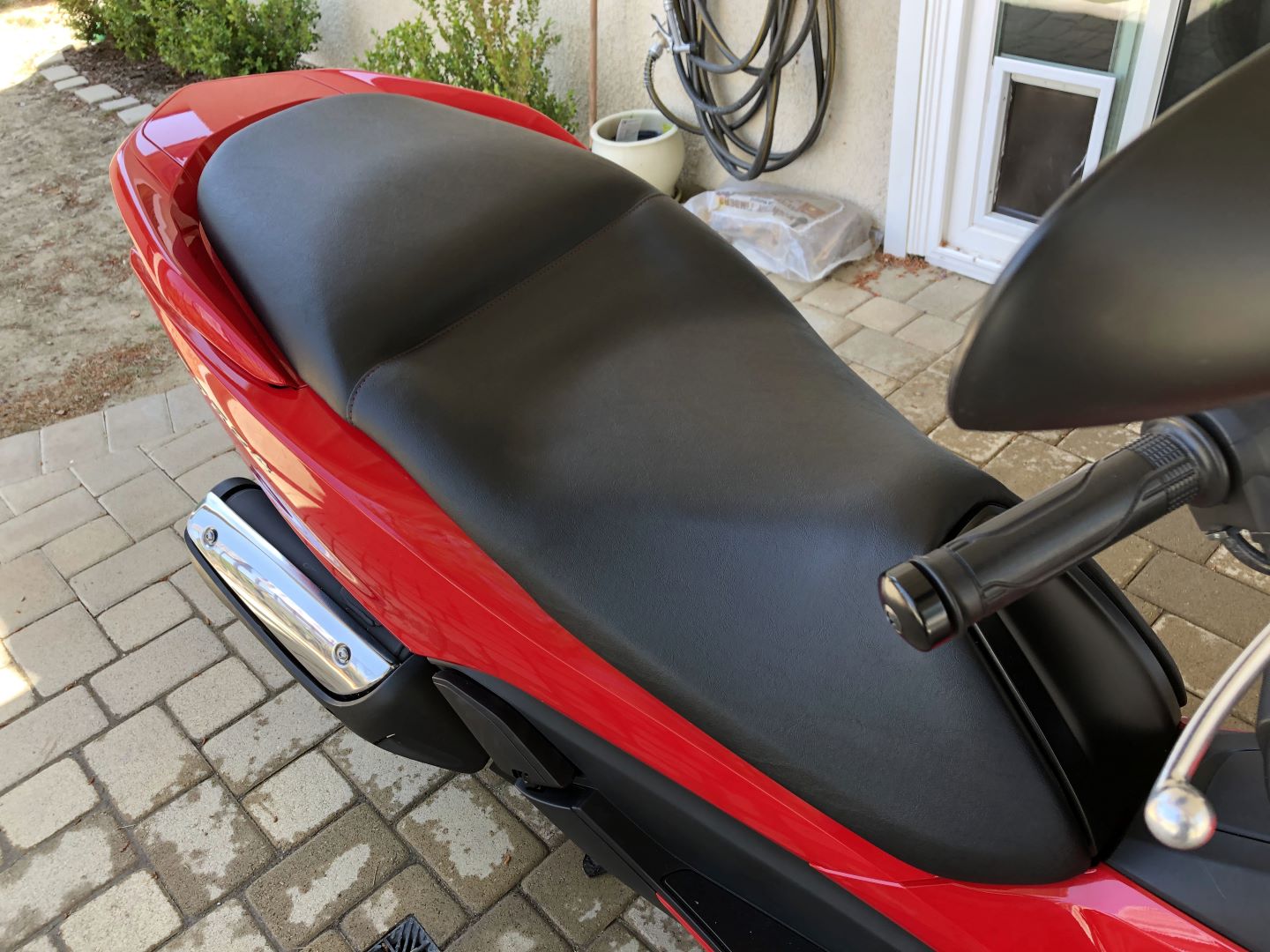

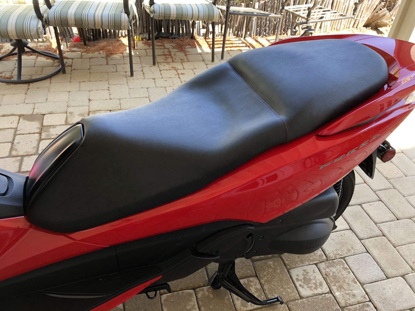

I too needed some extra leg room so I took apart my seat to see what could be done. I decided that cutting out "the hump" would be best. I fiber glassed in the hole I had created and had my local shop sculpt in some new foam and cover it up with a new seat skin.
Much better on leg room!!

Very nice. I didn't mess with the pan since I also ride with my wife, and she was not interested in me getting any of her "turf". I went back as far as the hump, but that was enough (along with some extra height/padding).
Re: Forza 300 seat mod
Few of these are as pretty as stock.....but then - whatever makes the owner happy. One can't see it anyway when it is being occupied.
