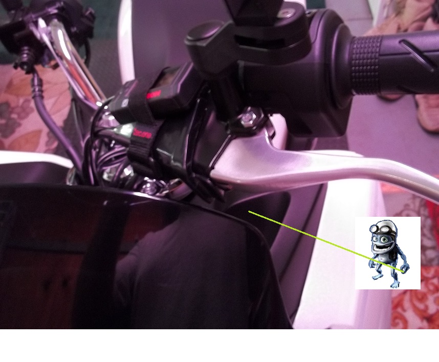

Don't abandon the project when you get a feel for how tight those hex bolts are
Note; don't forget to adjust the brake lever assemblies up as well to clear your windscreen and achieve a comfortable reach. VERY HAPPY NOW!
