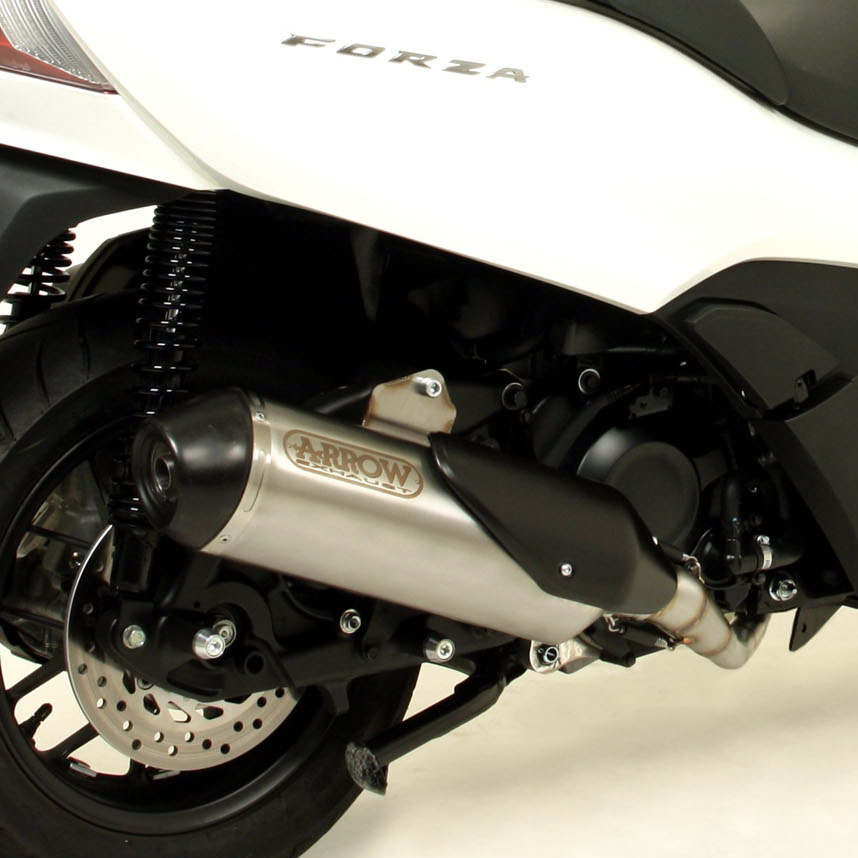

Has anyone installed it yet? Impressions...?

Gianelli with a different badge on.
Poor quality but probably cheaper than the original.

Arrow has poor quality? Maybe is not Akrapovic or Yoshimura but mate, reconsider! & i wouldn't say that is cheap. It costs €300. Akrapovic is €400.

Look at the picture, check the discoloured welds and the discoloured mount bracket.
That to me is poor quality.
Its cheaper than an original but still expensive.
The fact that something costs a lot of money is no guarantee of quality.

"GN2", if you really believe that Arrow delivers poor quality products, then you are clueless or shortsighted (or maybe you've never heard of this brand before)! The OEM part is out of this discussion anyway. & the fact that something costs a lot of money, there are WAY a lot of chances this thing has high quality & can last in depth of time.

I know that Arrow is a brand owned by Gianelli of Italy.
I have seen many of theoir exhaust systems, mostly on Triumphs.
I know, because I have seen with my own eyes, that their products are fabricated with low quality unfinished stainless steel, are held together with pop rivets and pigeon shit welds and are discoloured from new.
Compared with exhausts I've bought from Motad back in the day, the Arrow ones are shite.

Yes I have this system without cat on mine,really good fit and overall really pleased with it

Just installed an Arrow to my Forza, I agree with gn2 the weld discoloring could be better but overall I'm impressed with the manufacturing quality. If you get a chance look down the inlet of a new one and you'll see what I mean, also the way the DB killer is held in with a circlip, good engineering practise (I'm a mechanical fitter by trade) Was really easy to install and is half the weight of the original and sounds fantastic, cost about AUD$300 through Ebay...very pleased with it

After driving sport bikes for 20 years each with aftermarket I went with Arrow exhaust because the Forza sounds like a loud sewing machine without helmet on. With helmet and wind noise I have to check the tach to make sure it's still running. I like the thumper sound.

I agree with the attention to detail or there lack of. During initial inspection of the collector i found a 1 inch piece of welding wire inside. Nothing the needle-nose pliers couldn't remove but still...
