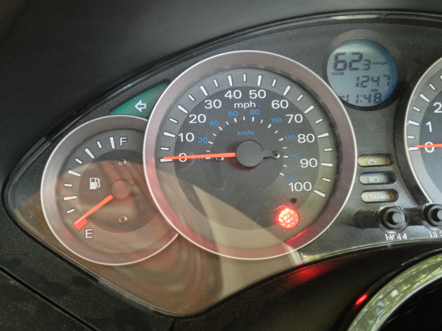

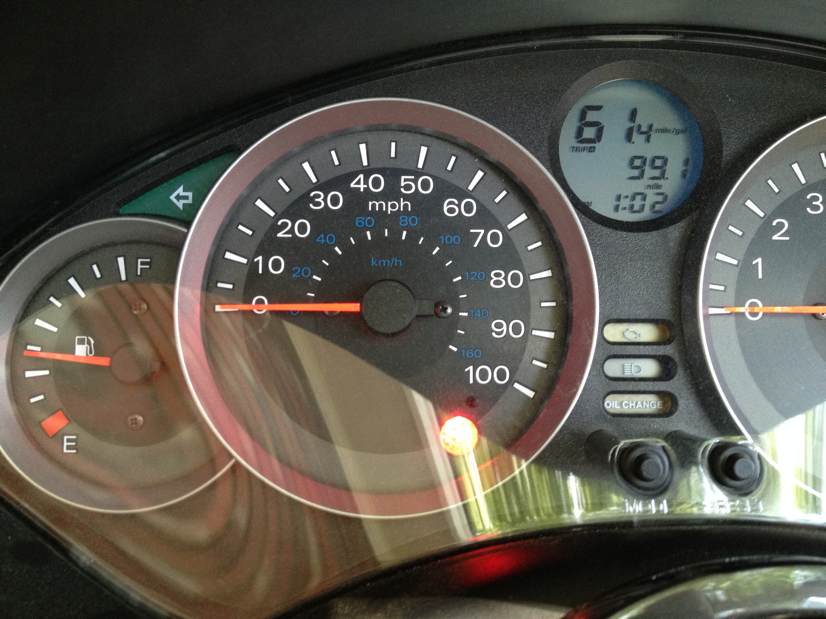

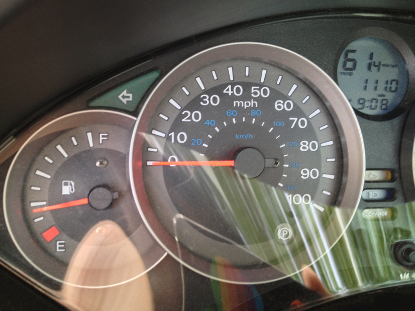

For this tank, I have taken a picture of the dashboard every time I have switched the beast on, and I have been more intentional about watching the gauges when I switched it on.
Yes, it is indeed a slow steady drop through the first two gallons. Predictable needle readings.
Once I got to about a gallon left (judging from the mpg gauge and the trip meter), the wake up gauge dance swings the gas gauge all the way to full pegged up, then all the way down full pegged down, then it pops up just a bit to rest in the red zone. At first, the needle was stopping in the top of the red zone, but within just a few miles, the needle would pop up to just the bottom of the red zone.
Let me try to post a couple of pix to show what I'm talking about.
I think I'm going to wait until about 160-170 miles on this tank before I fill up, just to see what the gauge does. But the sudden drop to red is definitely in keeping with the language in the US owner's manual, "Needle in red (E) mark, remaining fuel approximately 0.95 US gal (3.6 liters)".
HTH,
Michael
