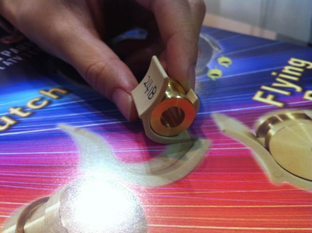

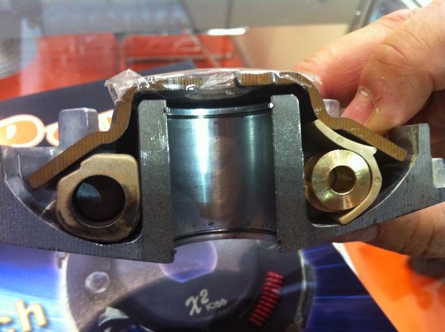

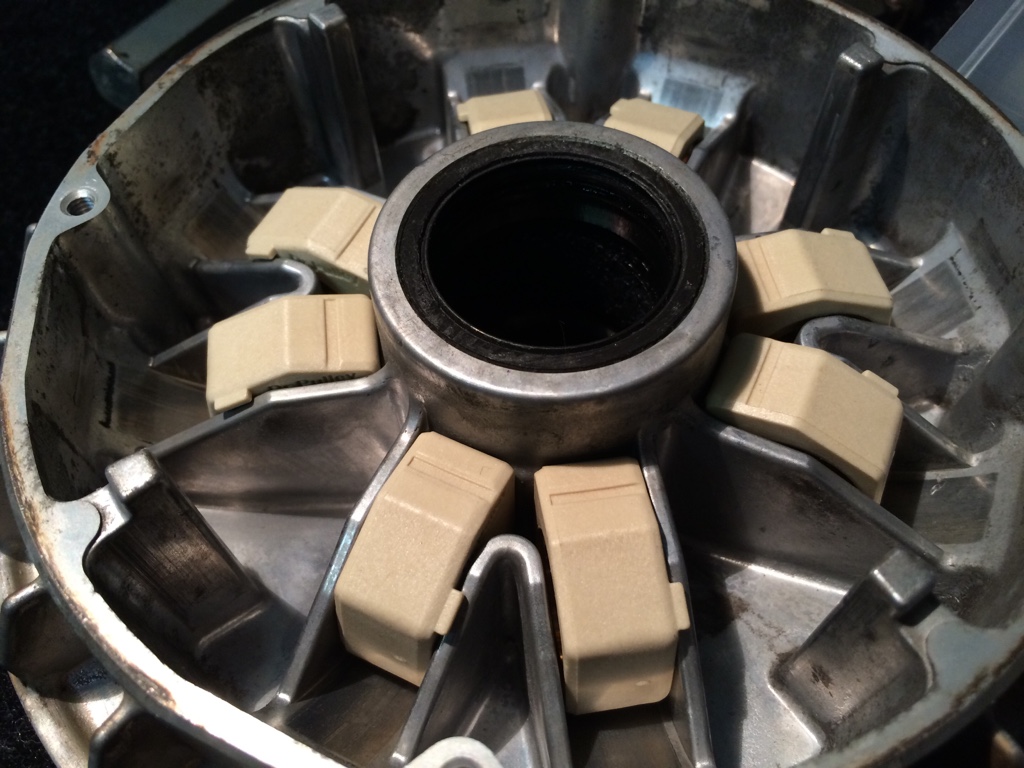

This are new sliders dr Pulley?
nuovi rulli pulley.jpg (119.12 KiB) Viewed 16484 times
nuovi pulley 2.jpg (104.02 KiB) Viewed 16484 times
dr pulley 3.jpg (223.12 KiB) Viewed 16484 times
