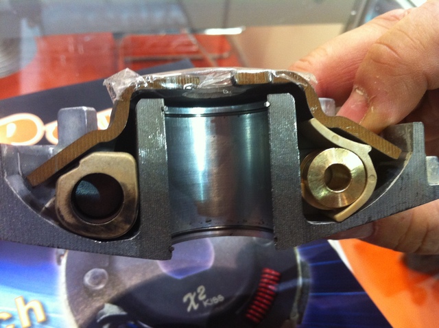

As a test of theory, I would suggest you first just replace 3 of your 21 gram rollers with 3 Adige 15 gram Carbon rollers....
I think you will be pleased with the result and it will only cost the price of the 15G rollers.
It will let you know if you like running mixed weights.

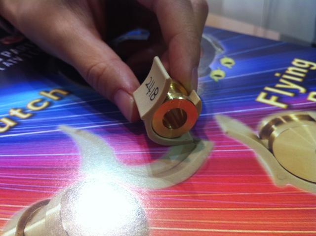

I like the Adige light weight rollers because the hard slick jackets show no signs of wear even after many miles....
sliders are designed to eliminate wear by using long flat bearing surfaces instead of a cylinder (roller).
After that if you still want more acceleration to improve 0-70mph time, then consider changing the 3 remaining heavier rollers (21G) to DR Pulley sliders in the 19-21G range.
If you mix sliders and rollers, the sliders should always be at least 3 grams heavier than the rollers so they control the shift points.

mixing rollers usually means there are 2 different diameters of weights being used.
Mixing sliders with rollers always involves 2 different sized weights.
It won't hurt anything, as long as they're 23x18.
I'm not sure I understand what your intentions are, but it sounds like you were talking about using all 6 15 gram rollers??
You definitely do NOT want to do that.
If you intend to use 6 rollers of the same weight, you need at least 18 gram rollers to retain top end speed.
mixing 3 heavy weights with 3 light weights allows you to use much lighter TOTAL weight than you can run effectively when using 6 identical weights.

DR Pulley's variator work better with all sliders than does the Honda variator with all sliders, but I don't think they make one for the 300 yet.....
any of the 250 series aftermarket clutches will fit the 300, but only an SH300 or NSS300 variator will work.
JCosta, Malossi and Polini make variators for the SH/NSS 300 series, but the OEM variator is more reliable.
on the Big Ruckus using 3 19g sliders and 3 15g rollers, I could almost duplicate the acceleration curve of the JCosta variator.
In fact we called that particular combination "the Poor Man's JCosta" since it followed the rpm curve of the Costa and had about the same 0-60 time...
the Costa could beat it in the long run.
On the Forza, 20G sliders and 16G rollers are 1 second slower @0-70, but will still hit a top speed of 87mph in less than a minute.

For hard acceleration out of corners and for overtaking and good max speed what is the alternative at 16 grams for me?
For me it is useless to attempt technical because you already know what's best.
Ruchus looks very strange. In italy doesn't exist, we love sofisticated design :-), but it looks like a bike that never breaks.....
ciao
This are new sliders dr Pulley?
nuovi rulli pulley.jpg (119.12 KiB) Viewed 16430 times
nuovi pulley 2.jpg (104.02 KiB) Viewed 16430 times
dr pulley 3.jpg (223.12 KiB) Viewed 16430 times
