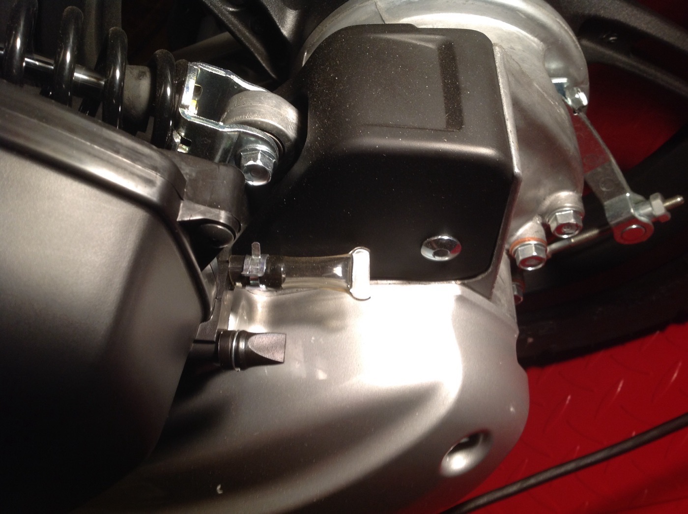

I have noticed on on the left side of my bike, as if i was sat on it, that there is a clear tube with liquid in it?
what is this and what does it indicate?
Does this indicate oil levels?

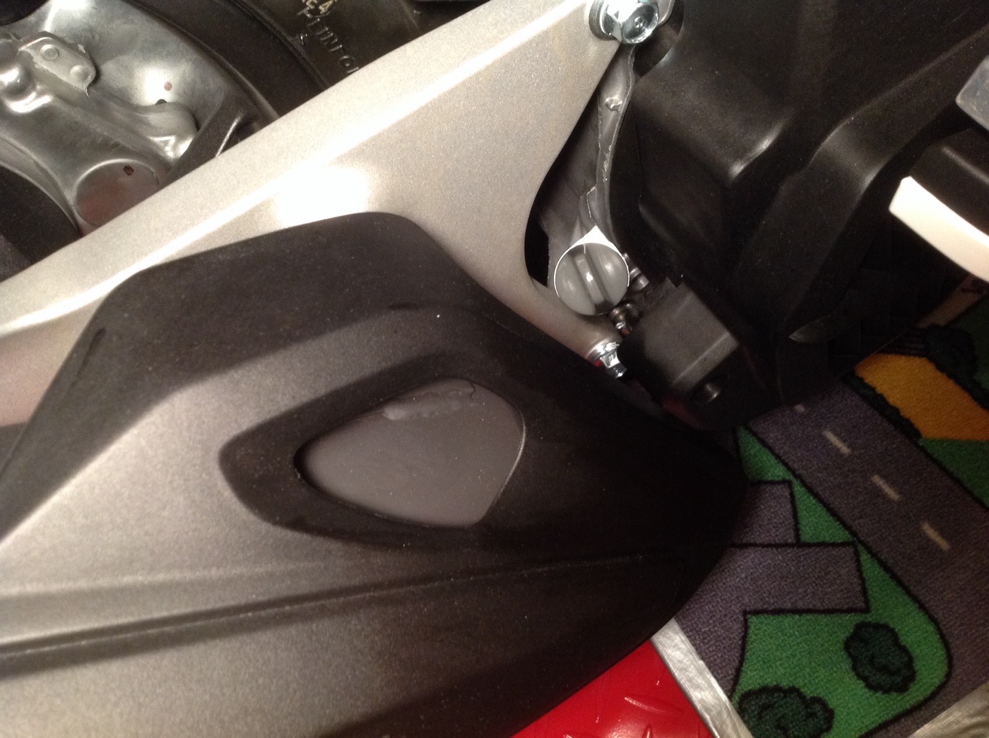

On the right side of the bike is the grey dipstick. Unscrew it, wipe it and pop it back in place WITHOUT screwing it back in. Pull it out and see if the oil is in the marked area.
Best to do this after the bike has been switched off for 5 mins and use the mainstand on a pretty level piece of ground

what is the clear plastic tube for? it was full when i got the bike and is about a qtr full now?you you wrote:On the right side of the bike is the grey dipstick. Unscrew it, wipe it and pop it back in place WITHOUT screwing it back in. Pull it out and see if the oil is in the marked area.
Re: How do I check my oil?
Its an overflow pipe.

The Clear (short) plastic tube on left side I believe you are referring to is the "breather drain plug" tube (as per 2014/2015 PCX Service Manual). Here's a photo from my 2015
And a photo of the oil dipstick cap on the right side
