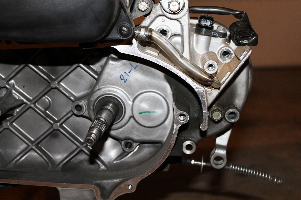

Next, remove the speedometer cover. There's an allen wrench at the front and back:
The speedometer sensor is clipped to the cover, so wiggle the back to the right to get it off the grommet on the back right side of the cover, then lift, exposing the speedometer cable. Gently unclip it.
Finally, unclip the little wire retention clip for the speedometer sensor and pull the cover off.

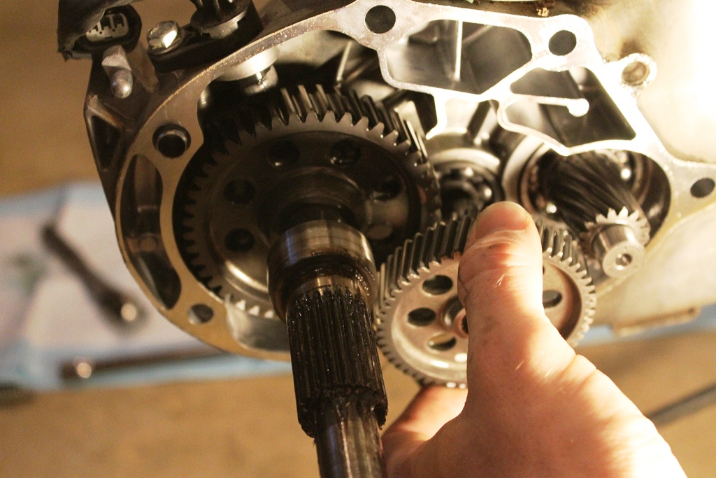

Here's our gears! Notice how it's rotated 180 degrees from the Honda Microfiche... Silly engineers. The Final Gear is on the left, the Counter Gear is in the middle, and the Drive Shaft is on the right. Remember, those are Honda terms, not mine. :lol:
The Kitaco kit replaces the center gear. The Yuminashi kit replaces the left gear (you have to use a press to get it off, then back on the shaft) and the gear hidden behind the center gear.
The center (Counter Gear) should pull out by hand.
Here's them side by side. Hell if I remember which is which, I took these pictures months ago. You can count the teeth if you want. They're very similar in appearance. If you are doing the Kitaco kit, drop the new gear in and reassemble and you're done.
The Final Gear and the Countershaft also just comes out by hand.

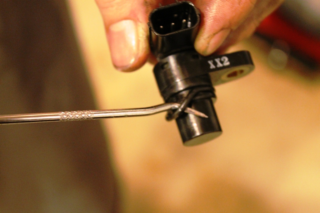

The speedometer sensor can be replaced if you bought one from Yuminashi. The stock one won't read off the smaller gear. It's a quick swap while you have everything apart. Remove the one bolt securing the sensor:
Old sensor on right, new sensor on left. Notice how the new one is longer.
Pull the oring off the old sensor gently. The new sensor does not include an oring, so you can reuse the old one:
Install the new sensor and reassemble. Again, please make sure to fill the transmission with fluid.
