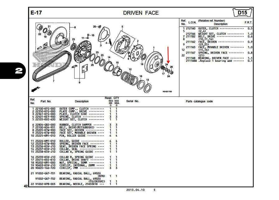

Hello there guys. Try these things (all together or one each time): 1) remove the tools from under the saddle, 2) remove the licence plate & 3) replace these two O-Rings (91301-K04-930), 4) lock the saddle when driving (i rarely do it so i don't use the button that much or if i need something during a ride i won't have to turn off the scooter in order to get it -Honda, you need a few slaps for this flaw & for the gas spring too-). Beside all these, if your rear tire is replaced with a wider one, there is a great chance that this is the reason of the resonance@4.400 r.p.m.!
- Driven Face.jpg (90.49 KiB) Viewed 11823 times
