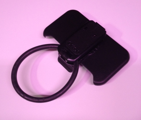

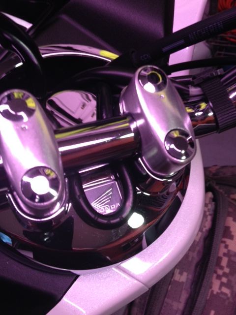

Buy the belt clip for your particular phone and a 5 dollar hover vacuum cleaner belt. Drill a hole in the bottom of your glove box and route the charging cord down through the steering column up into the glove box (note the hole has to be as big as the smallest end of your cord). Shove the belt between the handlebars and the column top plate then part way down into the column cable access port. The belt will wedge tight between the bars and plate but secure it anyway with a zip tie against any other decending cable inside the column.
This has served me extremely well and keeps a much lower profile than most over the counter solutions.
- belt.png (512.73 KiB) Viewed 13819 times
- mount.png (206.17 KiB) Viewed 13819 times

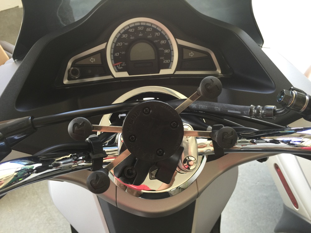

I like the look of this one from Ram Mount: http://www.rammount.com/part/RAM-HOL-UN7-400U

Chicaboo,
That is the exact model I have, mounted to one of the four bolts on the bar mount. Can't say enough good things about the item.
Good luck..I'll try to find a pic...
Mike
Mike

Wingscribe, that is the same one that I have on our bikes, and when we had our accident my wife had her phone on it, charging it. After the accident I had to pick the bike up off of her and take it out of the ditch. The phone was still attached quite securely.
