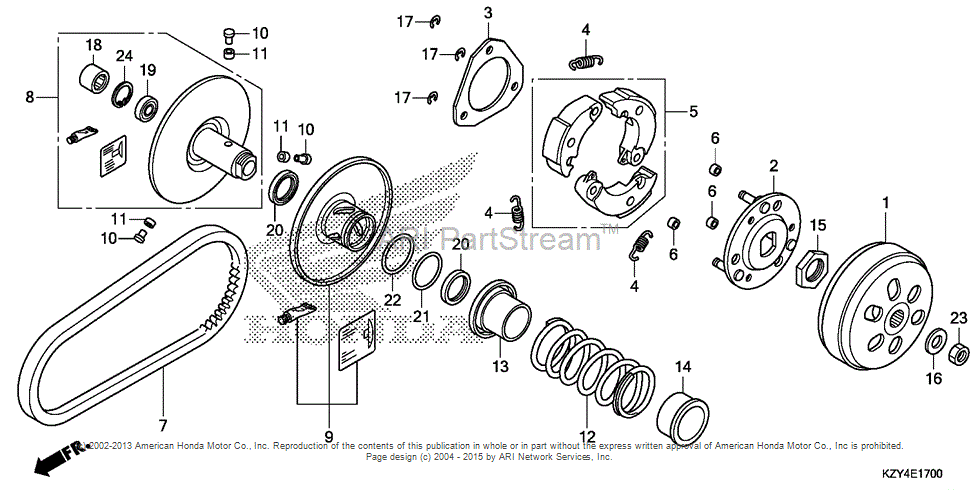

Installing a new Kitaco torque cam and I need to know the best way to remove parts #10 and #11 in the image below. They seem like they would be a press fit. Anyone have any ideas?

they just pull out with pliers, they will be heavily coated in grease.

I use magnet.

They would fall out if it weren't for the grease! Interesting idea of a magnet.
