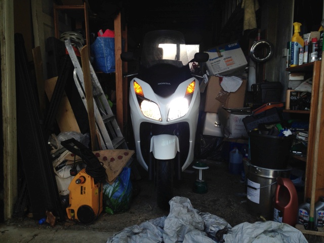

Since starting this thread, I have continued to commute on dark, unlit A and B roads in the UK, and with all the dirt and rainwater kicking up from the road and other traffic, I have to daily wipe down the patina of scum from my headlights and tail lights - the few times I've forgotten to do so, it's been hard to tell if my lights were on at all, untill I come up behind traffic and see my lights reflected off the back of the car in front. I get better light to see by from the car behind me than from my own lights, FFS.
I tried and failed to source HS1 HID upgrades. The 2 different suppliers I found on ebay could not supply the correct HS1 ring adapters... the kept supplying H4s or something else.. even after sending them photos of the OEM bulb fitting ring. So I gave up, but I found a supplier of LEDs in Canada. After an email exchange, with Jean Marc Dube, (who was very helpful) I established that this product would fit the bill for the Forza.
http://www.hdbright.com/hi-power-h4hs1- ... p-659.html
Delivery was pretty rapid considering it was coming from overseas. Took about a week. Fitting was breeze - I just had to slightly slit the rubber caps to allow the connector to fit through, but so far so good. I've not taken it out on my commute, yet.. but I was too excited to wait and wanted to post my findings so far.
The LED bulbs are significantly brighter and whiter in low beam mode, but although I can't verify this yet, I suspect that the high beam mode will not be as much of a relative increase in brightness over the low beam as original incandescent bulbs had. If I can remember how to host/upload photos to this forum. I shall share the photos which might explain this phenomenon better. Either way it was an improvement over the low beam brightness that I was after, and these LED bulbs have delivered that much for sure.

Ah! "Full editor" mode engaged:
- The bulb on the right is the new LED bulb. My phone doesn't quite do the difference justice.
- IMG_4675small.jpg (111.47 KiB) Viewed 12029 times
