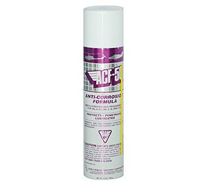

I use ACF50. My bikes nearly 4 years old and it's still pretty mint. It stops the alloy parts getting that powdery corrosion on them. Keeping it clean and avoiding leaving it it covered in road salt also helps.
It's about £13 a can but it lasts for ages. It's designed for the aviation industry, I think for planes on aircraft carriers to stop corrosion. The grease is good as well. It stops the center stand seizing up.

I found it! I can't wait to clean my scoot and protect it.
http://www.aircraftspruce.ca/catalog/cspages/acf50.php

ACF-50 will not harm plastics.
There's plenty video tutorials on YouTube of how to apply it.
The way I do it: spray it on a cloth and wipe on.

It's fine everywhere except for brakes obviously and taped up wiring looms don't like it as it melts the glue on the tape causing the looms to unravel a bit. So try and keep clear of them. Don't worry if it gets on the exhaust it will just burn off.
A mate of mine works at a BMW bike place nearby and all the demos are covered in the stuff. They have an off road course they use so they get properly used and abused.

I don't think there is a problem with that.
Re: how to prevent rust
Stick it on anything metal, suspension, brakes, radiator, engine, electrics, everywhere.
It soon burns off the discs and pads.

I don't think that would be a good idea. It's really for exterior use. I personally wouldn't go near the brakes either.

Another vote for ACF50, and I echo the above, avoid the brakes and I would not spray it in the exhaust!
