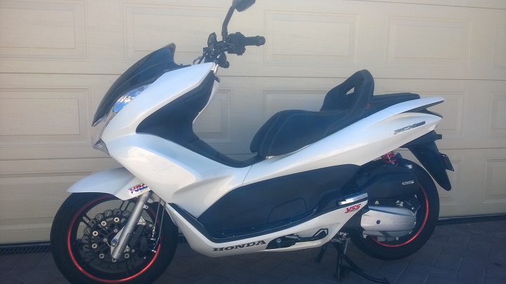

you can make quite a difference to the braking on the pcx. I am running a KN Planning 260mm front disc, Kitaco braided lines, Kitaco SBS sintered pads and a good quality DOT4 fluid. The lines and the pads make the biggest change by far, I installed them first to see what they could do and then installed the disc. The disc didnt make anywhere near as much of a change as the other parts but it looks awesome so it will stay.

Went for EBC sintered pads, 260mm disk, braided hose for the front, adjustable shorty levers and a good fresh brake fluid every spring.
It is still not what I got used to on the 600rr, but it is night and day compared to stock brakes.
