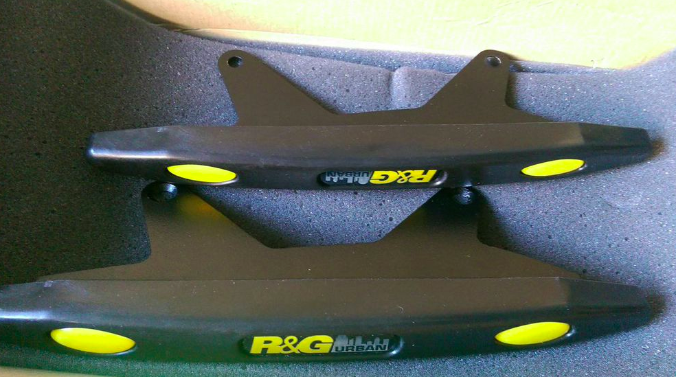

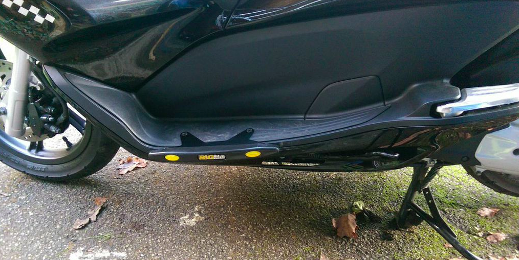

Every bike I had I put on R&G sliders or some (Hepco & Becker) crash bars. So I thought why not the little PCX, too - they always paid off in the end.
I am a little disappointed by the way they look on the scooter. Some horrible yellow blobs totally spoil the looks of it. What is that "Urban" logo thingy? I can see how they will probably protect part of the plastics lower down, but the handlebars still are by far the widest part of the bike and I don´t think they are able to protect the upper fairing. Its not even close to the protection I saw on some scooters back in Turkey with 360 degrees crash bars on their scooters, either.
I may not see how they will protect the plastics, I need to paint them black (and they make me look like a teenager) but they make for excellent foot board extensions :-) much comfier foot positioning for me now.

Don't you find that those things are digging in to your legs every time you come to a stop?

Wouldn't even notice it with my bootssendler2112 wrote:Don't you find that those things are digging in to your legs every time you come to a stop?
Besides, I think it would be well worth it. When I went down at 10 mph, the outer part of my boot caught the ground, forcing my leg to twist until the tibia & fibia broke. I think it would be nice for something else to catch the ground instead.

These sliders look as well made as any other R&G sliders I got, sturdy metal base and some hard plastic/organic material on top. I may not like the looks but I keep them there, they don´t disturb me when I stop, don´t feel them when stationary (but then I have a wide(ish) step).

The edge of the stock running board is a fulcrum just waiting to pin your leg into the ground and break it in a tip over and those things sticking out just make it worse.Valiant wrote: Wouldn't even notice it with my boots.

IMO, the issue is that the floorboard doesn't go deep enough to rest your entire foot inside, and perhaps they could have placed something(sturdier than plastic) that also raised up a bit on the edge to keep your foot inside should it tip over. From what I could tell on the x-ray, my leg didn't get pinned into the ground at any point, just twisted and broke.
A rear wheel slideout should shove your leg straight up and away from the boards. If your front tire slides out and you manage to turn the PCX 90 degrees from your forward position, then there might be a problem with your leg being pinned under the board, but that's honestly less of a problem with my MX boots.

I guess if you put them on far enough forward the wouldn't tend to dig into your legs in a crash.

Looks like the bracket holding the slider might just bend up upon impact. The slide material itself looks durable, but the way they mount looks fragile and unreliable to me.

The mounts are sturdier and with more metal then the sliders I had on my BMW F800S. On the 217Kg bike the slider only had one single pin to hold it to the frame, and it did hold when I went down. Here you have an entire metal bracket and two anchor points and I am fully confident that the sliders will stay on with a Scoot half the weight of my Beemer.

Just from the way they mount, looks like if the bike slid down toward the direction of the kickstand, the metal is thin enough on the slider that it would bend upward. My other concern would be what those mounting screws are actually screwing into. Plastic? Metal?
The type of sliders that are more of a hockey puck style with a central mount bolt into the frame make some sense to me. This style looks too easily compromised. Of course, on the PCX you don't really have any good hard points for slider mounts like on some bikes. If you dump a PCX, you're probably going to have some banged up plastic, sliders or not, just due to the nature of how a PCX is constructed.
PCX plastic comes prepainted from Honda, and is dirt cheap, at least in the USA. Very inexpensive to fix the bodywork in comparision to most things on two wheels. It's so cheap it's not even really worth worrying about. Not sure outside North America...
But that's just from looking at a picture online, so hard to say with any certainty. The key is not what I think, it's what you think, since it's your money.

R&G makes good stuff and I am confident they will withstand a slide or drop. They look and feel sturdy and so do the mounts, if anything, I have a more comfy position for my feet.
70 quid ain´t really money compared to what stuff for big bikes costs. I keep them where they are.

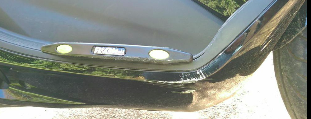

Hi all,
Just wanted to report back on the effectiveness of these. I had a chance to test them out before the 23rd of February when I went to Vietnam, due to my own stupidity (please don´t ask how). It was a fairly low speed crash, roughly 10 - 15 mph. I landed on my right side and am impressed. I think it kept the scooter more upright, otherwise the front plastic panel would have split and break instead of just scratch. The handlebars did not touch the ground and from a distance its not possible to see any crash damage.
I big off might have been a different story, but at once only stupid moment is certainly better with them then without them.

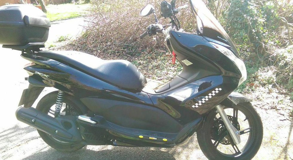

tiny scratches and a bent crash bar, thats it.
