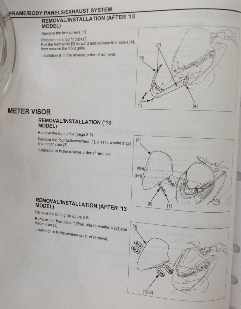

Hi guys,
Just wonder how can we remove the windshield on the new pcx 2014? Is it the same process as the old model?
I tried to google but there are no information about this.
Thanks a lot.

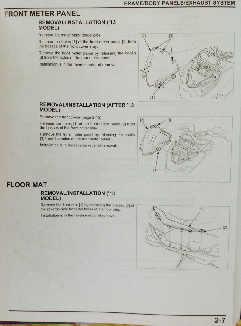

Not the best of copies but, here are photos from my 2013-2015 PCX manual. I haven't replaced my stock screen yet (I like it), but I bet the exchange is easy and a 10-15 minute job (maybe less?)
NOTE! Make sure you follow the proper instructions for the proper Year PCX! 2013 "or after" 2013.
Print them, if you want to

Thank you so much for the fast reply WhiteNoise, hope you enjoyed your holiday, cheers!
