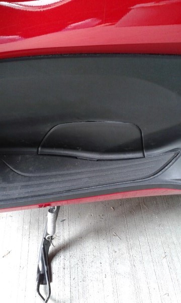

While doing my side stand switch mod i noticed a couple easier ways to get to the valve cover, the spark plug cover is easy!!! Remover the rubber foot pad remove one screw for the cover and there you go. I tried getting to all 4 screws with a small 1/4 inch drive ratchet with success i did not remove the valve cover but i could have removed the screws!
The second way which provides more room is to remove the bottom painted panel the one the side stand goes through, then look at the front of the scoot there is a support brace, round tubing with 2 bolts holding it on....remove them and the brace... slide the black kick panel forward it should come off alot more space available. There is one screw at the back holding it on.
Either option is way easier than removing all the panels and coming in from the top! 500 more miles and i will try this method .

To adjust the valves like this, you need to be a good gynaecologist.Drifter wrote:While doing my side stand switch mod i noticed a couple easier ways to get to the valve cover, the spark plug cover is easy!!! Remover the rubber foot pad remove one screw for the cover and there you go. I tried getting to all 4 screws with a small 1/4 inch drive ratchet with success i did not remove the valve cover but i could have removed the screws!

I got my hand and ratchet in there with just the small panel removed and the red bottom panel using a flash light to see, it was not that hard to do. Take off the black kick panel and you could put both arms in there!

A bit cramped for safety reasons and not good to put the cover back on esp. with sealant.Drifter wrote:I got my hand and ratchet in there with just the small panel removed and the red bottom panel using a flash light to see, it was not that hard to do. Take off the black kick panel and you could put both arms in there!

What safety reasons, anything you do on this scoot or car etc. is cramped normal fact of life one reason they charge so much to work on stuff!
Its always good to put the valve cover back on!!!!
