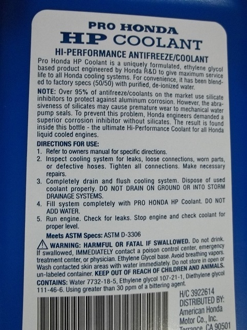

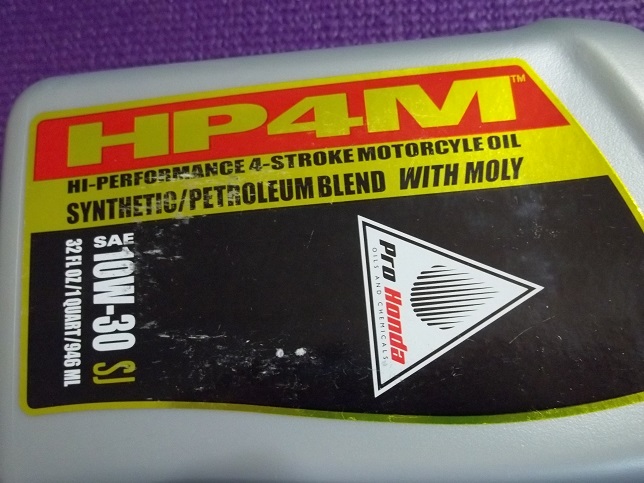

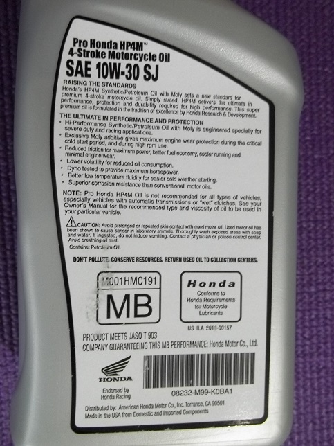

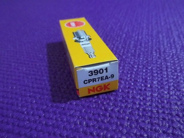

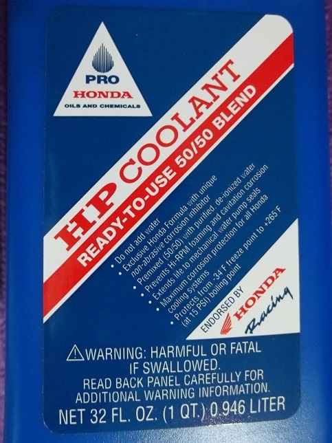

These are the proprietary Honda products recommended for PCX as of the 2013-15 service manual. Are they anything special... I doubt it but if anything can be damaged by using other fluids or spark plugs at least you will know it wasn't your choices

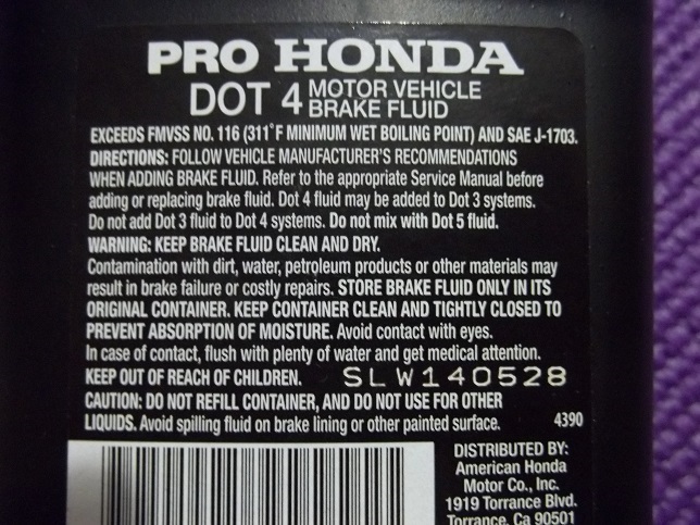

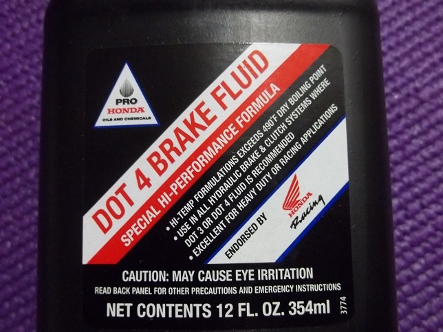

Honda doesn't specify their brake fluid in the SM other than "DOT 3 or 4" however they do offer Pro Honda Brake Fluid DOT 4 in 12 oz. Not sure why they specify everything but their own brake fluid.
- oil.jpg (206.88 KiB) Viewed 7864 times
- oil2.jpg (217.45 KiB) Viewed 7864 times
- coolant.jpg (230.53 KiB) Viewed 7864 times
- coolant2.jpg (247.8 KiB) Viewed 7864 times
- 100_2598.JPG (208.14 KiB) Viewed 7864 times

The HP4M has moly . The Honda engineers are specific on this for some reason ( I even called Honda corporate , who advised it's use especially in the final drive). Some members will say too "just put whatever you want in thar"..... . I commend you for researching . I'm confident most members here are not engineers , me included , go with Honda specs , there's nothing wrong with your logic .

Re: Pro Honda recommended fluids & spark plug...
Be sure to check the wet and dry boiling points of whichever brake fluid you choose ( Honda specs).

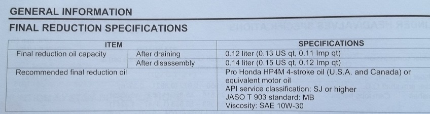

Again gn2 is correct, the term 'final drive' is how Honda describes our PCX gear oil. Although Honda sells its own proprietary gear oil we don't need it as PCX owners. I will remove the image immediately... sorrygn2 wrote:I seem to recall that the oil for a PCX final drive is the same oil as goes in the engine.
- finaldrive oil.jpg (159.43 KiB) Viewed 7819 times
DAM!!!.. 'FINAL REDUCTION' is how the 2013-15 SM describes our gear box NOT final drive.
good catch GN
good catch GN
I mentioned HP4M when I bought my 2015 this past November and was chastised by several members . Glad to see this thread regarding proper fluids .
Final drive or final reduction , SM advises of HP4M regardless of some members differing opinion . The engineers of Honda specify this lube . Some shade tree members here advocate. ...."just put what-cha want in thar ".....just like the engine.
- maddiedog
- Benevolent Overlord
- Posts: 3648
- Location: New Mexico
It's not shade-tree, it's what the manual says.frog13 wrote:Final drive or final reduction , SM advises of HP4M regardless of some members differing opinion . The engineers of Honda specify this lube . Some shade tree members here advocate. ...."just put what-cha want in thar ".....just like the engine.
The same engine oil is fine in the final drive gears.
The last of it arrived... some information on the bottle might be of interest
- brakefluid.jpg (218.51 KiB) Viewed 7767 times
- brakefluid2.jpg (244.01 KiB) Viewed 7767 times
Well aware of what Honda recommends , it's other's who have advised in different threads to put in different rather than spec., Not I . And yes , the SM does say to use HP4M in the final drivemaddiedog wrote:It's not shade-tree, it's what the manual says.frog13 wrote:Final drive or final reduction , SM advises of HP4M regardless of some members differing opinion . The engineers of Honda specify this lube . Some shade tree members here advocate. ...."just put what-cha want in thar ".....just like the engine.![]()
