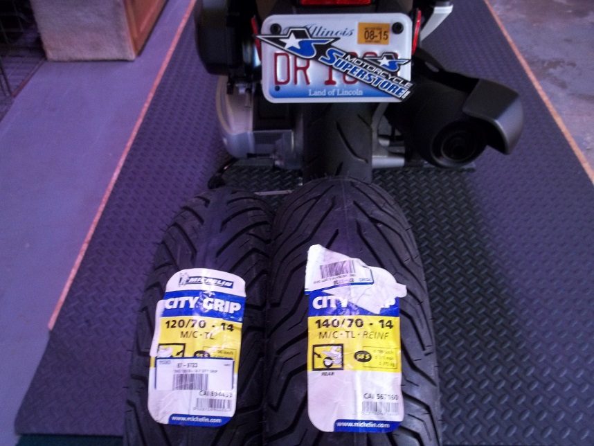

What is the size and brand of tire you used?
Re: Biggest Tire.
Drifter wrote:What is the size and brand of tire you used?
Here ya go friend... be sure to understand your speedometer will show a couple mph slower than actual speed. Your top end speed will drop 4-5 mph and that probably will not set well with you so next you will need a kit for your CVT to get back the speed plus 4 mph. In the end you can expect 69 mph downhill with big tires and a variator performance kit on 2015pcx. See Scooterman for earlier model mods. Total cost of riding big tires fast 250.00

Looks sharp 8) rubber to road feels awesome with big Miche's and of course if I put my stock tires back on at this point it would go super nimble and as fast as others with NCY kits installed. Basically I wanted the big rubber look and no loss of factory speed and that was achieved with help from members here. But I would have trouble moving back into stock tires sizes so don't do it for speed :lol:

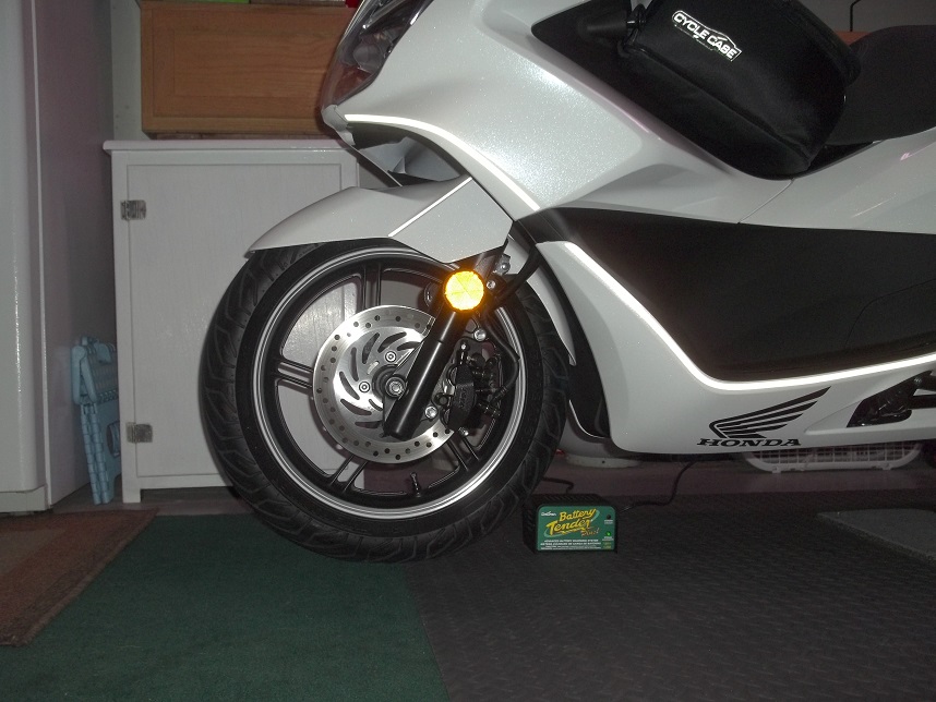

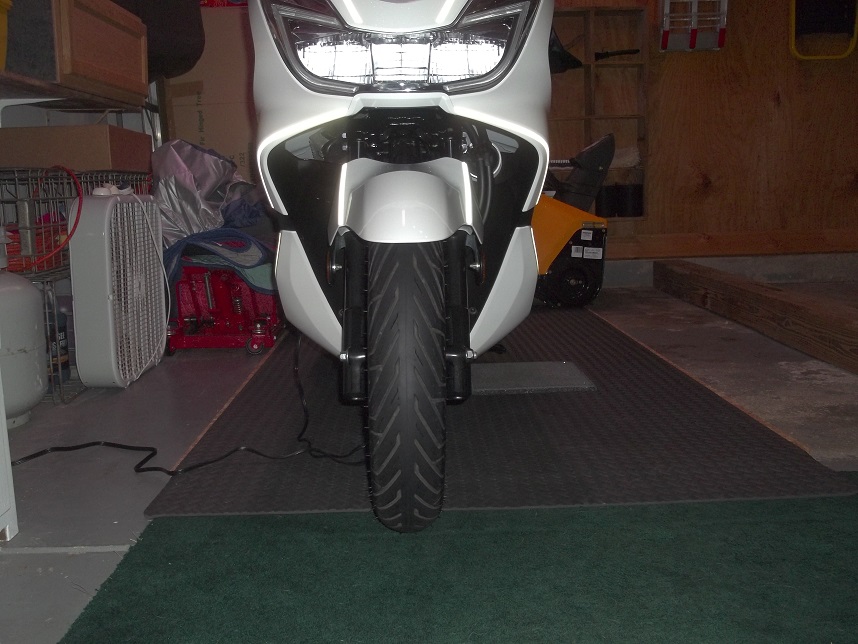

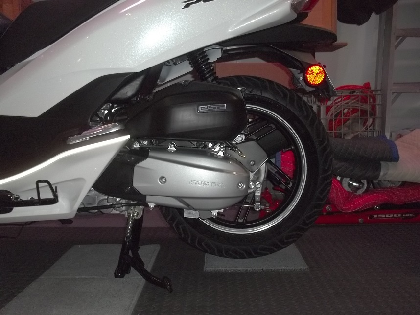

Do you have a side pic of the tires installed? That is quite a bit more rubber and weight! Did you weigh the tires before mounting to see the diff? How much taller are the ones shown?
I live on flat Florida ground, no worries about hills, except the ones fire ants build! Nasty critters!
Re: Biggest Tire.
Drifter wrote:Do you have a side pic of the tires installed? That is quite a bit more rubber and weight! Did you weigh the tires before mounting to see the diff? How much taller are the ones shown?
They look much smaller after mounting, the rims pull them in considerably. I think you add 3 lbs each so you have to lose 6 pounds. Lay off the cheese puffs and call it a wash :lol:

Front looks bigger, cant tell much on the rear. Does the wind blow you around any less now? How many MPG did you lose do they ride better, meaning smoother over bumps? They look better than the skinny tires for sure!
Re: Biggest Tire.
Drifter wrote:Front looks bigger, cant tell much on the rear. Does the wind blow you around any less now? How many MPG did you lose do they ride better, meaning smoother over bumps? They look better than the skinny tires for sure!
Considerably bigger rear tire! Winter grounded me shortly after my mods so I don't have accurate mpg but I will speculate from others and what little I did see upper 70's maybe lower 80's miles per gallon. Plan on losing 20 miles per gallon with a 150 and large tires... those spindly stock tires are going to be why you get 100+ mpg. If you are fuel thrifty don't fatten up 8)

Hey Homie, where did you pick up your tires ? Cant find much around CHI -TOWN
Re: Biggest Tire.
GlassMan wrote:Hey Homie, where did you pick up your tires ? Cant find much around CHI -TOWN
motorcycle superstore http://www.motorcycle-superstore.com/60 ... aQod6zIAmQ

Thanks Homie,thinking of going the same route. Love the look! Comparison pic is awsome.
Re: Biggest Tire.
GlassMan wrote:Thanks Homie,thinking of going the same route. Love the look! Comparison pic is awsome.
