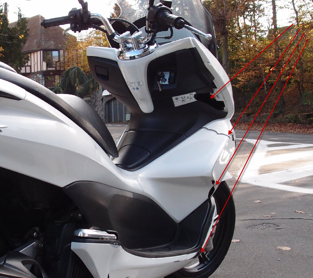

Hi there,
My daughter had a close encounter with another vehicle : she's fine but the 2011 PCX suffered cosmetic damage ... o_O
From the attached picture, could you help me determine what cover parts I would need to replace. Furthermore, does someone have experience with removing and replacing these panels (i.e. required tools, tips, etc)?
Any advice is welcome.
Cheers!
PCX damage.jpg (213.54 KiB) Viewed 1518 times

Go to bikebandit.com and check their parts diagram. It looks like you need 3 parts. The parts themselves are cheap enough. Changing them out is quite a chore though. Just take your time. Get some automotive trim removal tools (quite cheap at Harbor Freight) and just have patience. I hope you have a service manual, but if not there are some threads on this forum about taking the bike apart. Maddiedog did a good job of showing us how.

Thanks for the info and the links ... as daunting as it might look, it seems quite possible!

It is quite possible. We had to change out those panels on one of our bikes, so i know it can be done. It isn't as easy as other parts we have changed but it can be done with a little patience.

Hello Mel46
Thanks for the instructions : it worked like a charm ( albeit with a bit of pull/tug here and there!). I ordered the parts from B.B. and replaced as mentionned. One thing though: European PCX owners should double check when ordering certain parts (namely the CVR (INNER) *NH1*).
