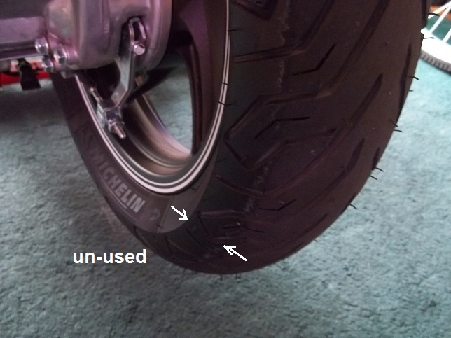

Beautiful 63 degrees today, I've been on the new rubber for hours noting the ride and handling with no complaints so far.
I actually sparked the center stand feeling too confident o_O so I stopped trying to rough up the outer edges of the Michelins
There is a lot of rubber you will never use on these tires because of the C-stand ;)
