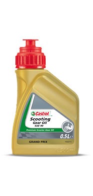

Re: Final Drive oil change??
There is a final drive oil available from castrol.
http://www.castrolmoto.com/en/products/ ... ar_oil.php
I'm never very sure about the shear qualities of engine oil so this might be better.
The manual does say use 10w/30 though.
