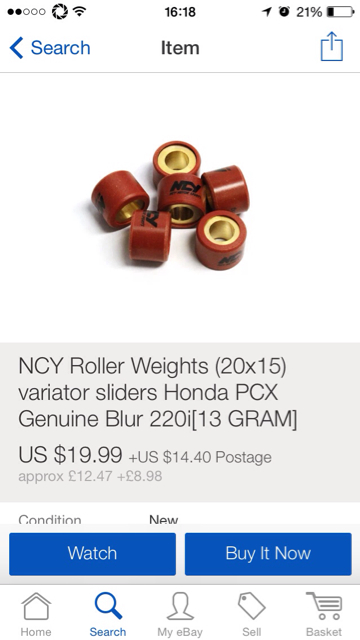

Well cheap ish. Under $200. Am i looking at 12g sliders? What size are the pcx 125esp sliders?
Honda PCX 125 ESP (Black)

Post by nribeiro »
20x15... Try 13gr.

Re: Legal modifications for extra speed
Post by Urbanfreestyle »
would these work?
nribeiro
Posts: 95
Joined: Sat Apr 26, 2014 2:29 pm
Post by nribeiro »
Yah but I meant sliders. Sorry
