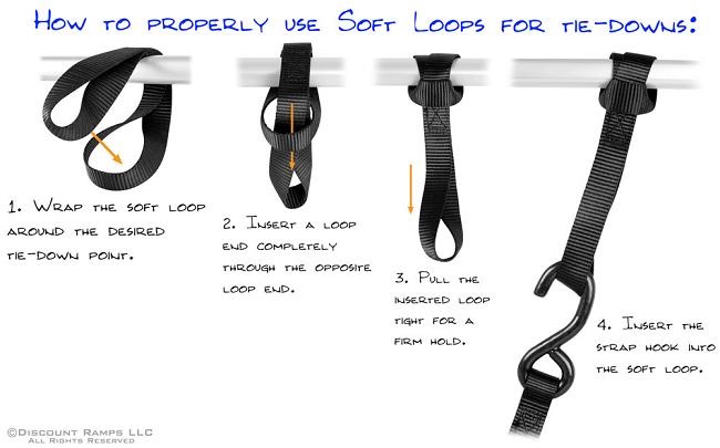

These are called soft loops, Not the same as the fuzzy furry ones I just mentioned.
Here's how to use them:
Brought to you by Discount Ramps (good website

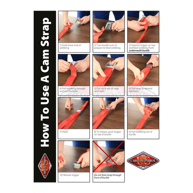

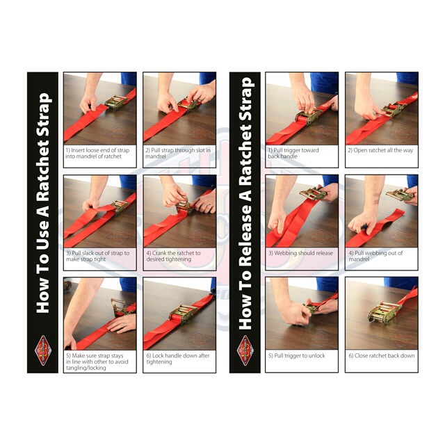

How to work those straps

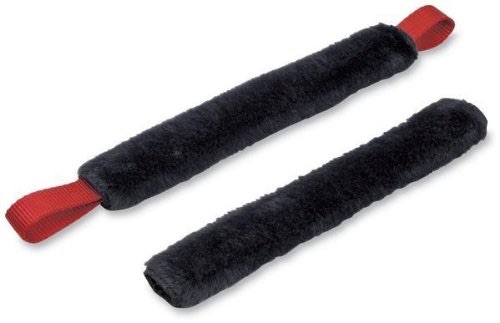

Oops, and the soft tie "covers." Those furry wraps that Velcro over your tie straps. These keep your ties from scratching your Bike (Should they Meet
1" and 1 1/2" width sold here:
http://www.amazon.com/Powertye-Plush-So ... +tie+downs
