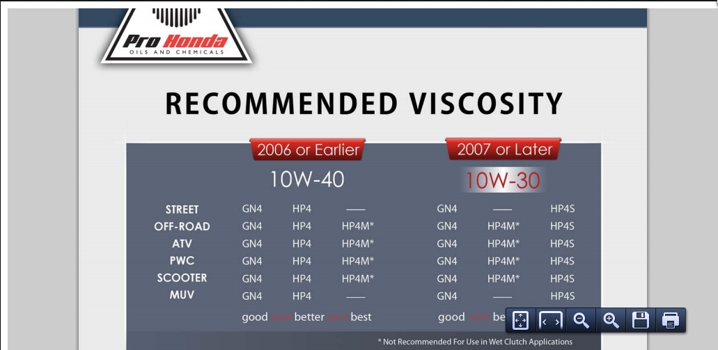

Here is what I found on the Pro Honda Oil website. Since I am not in a hurry, I think that I'll exchange it for the 10W-30.
Re: GN4 10W-30 or 10W-40
Yes, owner's manual and service manual agrees with you....even though my dealer said either oil is OK..and sold me the 10/40..I'm going with the manuals and purchased the 10/30M and put it in and will use for all future changes.

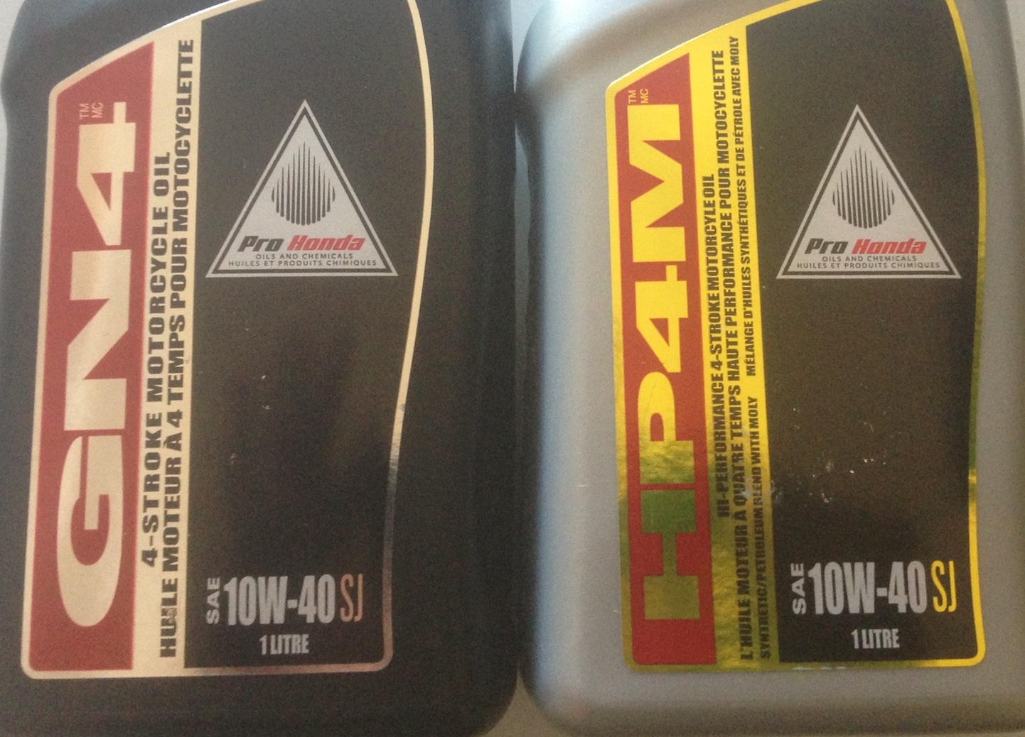

The owners manual and service manual recommend Pro Honda oil HP4M. The "M" stands for molybdenum (moly) which is an additive that increases the "slipperiness" of the oil...good for reducing cam and lifter wear and other engine parts. It's not recommended for motorcycles with wet clutches, but we don't have that concern with the Forza.
Posts: 2862
Year: 2014 125 (LED)
Location: London, England
Post by iceman »
Most modern oils esp. fully synth have added stuff to make the oil better at lubrication for longer - you do not need special Honda oil. Honda sometimes uses Moly other manufacturers use all kinds of things that do the very same thing. If your in the UK, Castrol fully synth Power 1 Racing 4T gets Honda's and Suzuki's recommendation - over the top for the PCX but still a top-notch fully synth 4T long lasting oil (10w30 or 10w40) and a nice price too (4L's for £31 delivered off Amazon).
